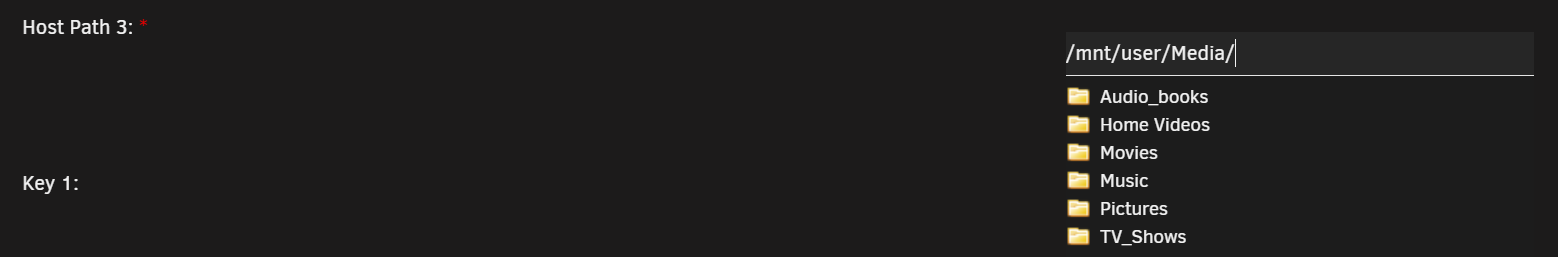

Trying to migrate my Plex server (from WIndows) to a docker on unRaid.. I copied the plexmediaserver folder to appdata after installing the (official) docker.  I set the host path 3 to my media share as shown here:

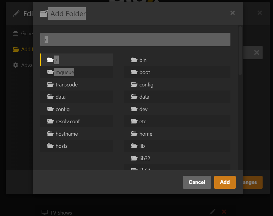

Unfortunately when I go to  run the Plex setup, I can't see these files.. this is what I see:
Any thoughts on what's happening and how to fix it?

next to the path for Host Path 3, what does it say the container path is?
/data? /media?
/data? /media?
SOrry forgot to chime back in, thsi was the issue ( was still learning how mounts work in Docker ad didn't know to look for the container path name (which was /data and you can see it right there in my screenshot), not the actual path
