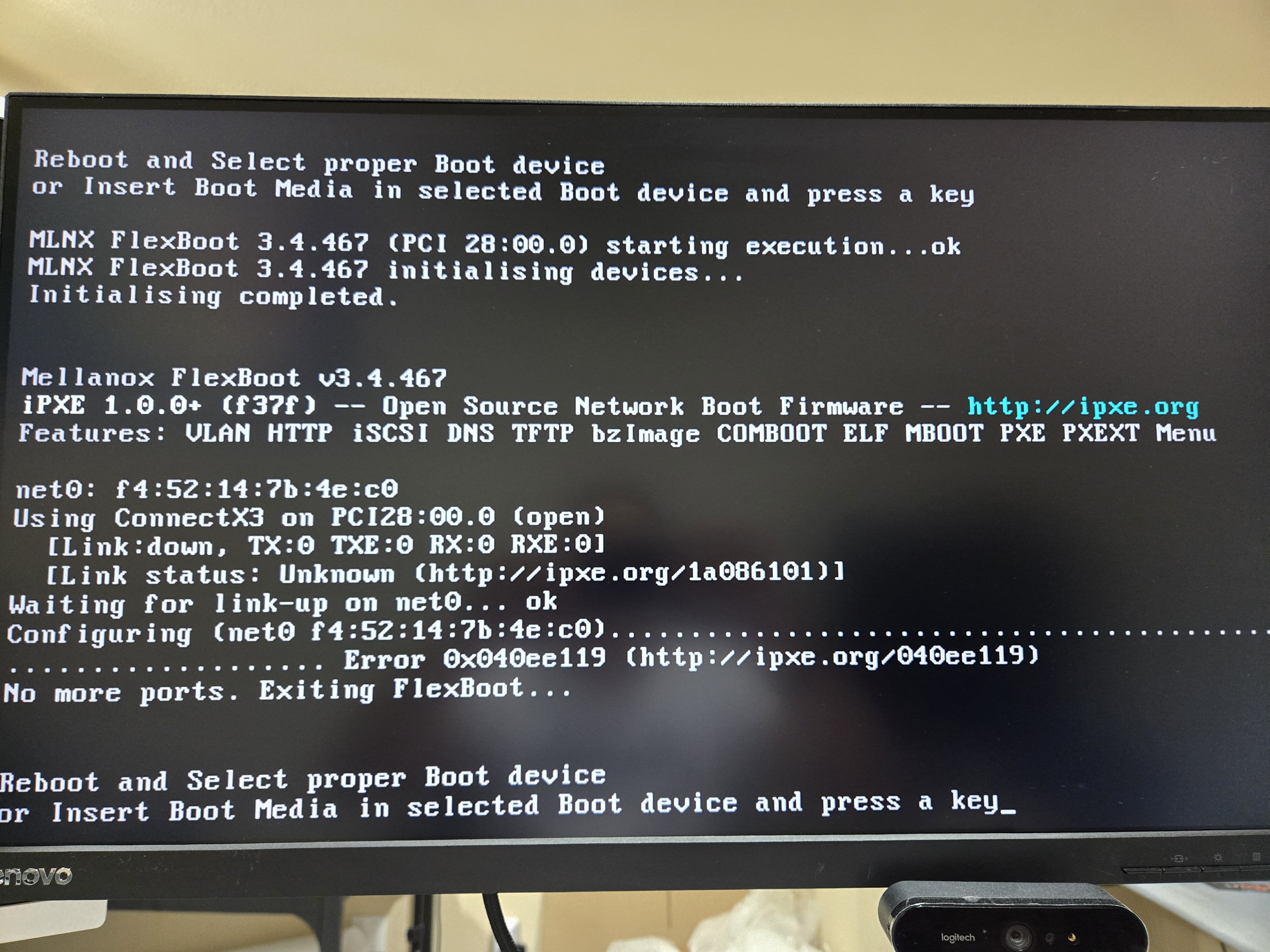

I have an issue that has suddenly caused the unraid server to not respond. I have a mellanox connectx3 card for 10gb and I have the same usb that I have been using for a while. Tried restarting but Some issue on flexboot us causing the boot to fail.
Please see attached image. Happy to share information about the hardware however not sure if that's relevant here. Has anyone seen this before?
That suggests the flash drive is not set as a boot option, or it's just damaged.
You should also be able to disable the Mellanox boot ROM, assuming the BIOS supports that.
Did you ever solve this?
