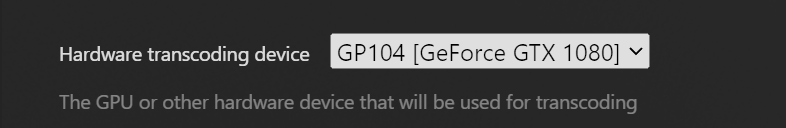

I'm trying to setup plex media server ( docker ) to use my GPU. The GPU is recognized by Plex, and hardware transcoding starts but stops almost immediately after beginning, I get a few seconds of transcoded content. There are no clear errors in the logs indicating why the process is being terminated. ( that I can find anyway ) Searched through the Plex Media Server.log for any indication of what’s causing the issue. Relevant entries included:
- Transcode process starts successfully but stops without any clear error message. ( checked GPU util using nvidia-smi )

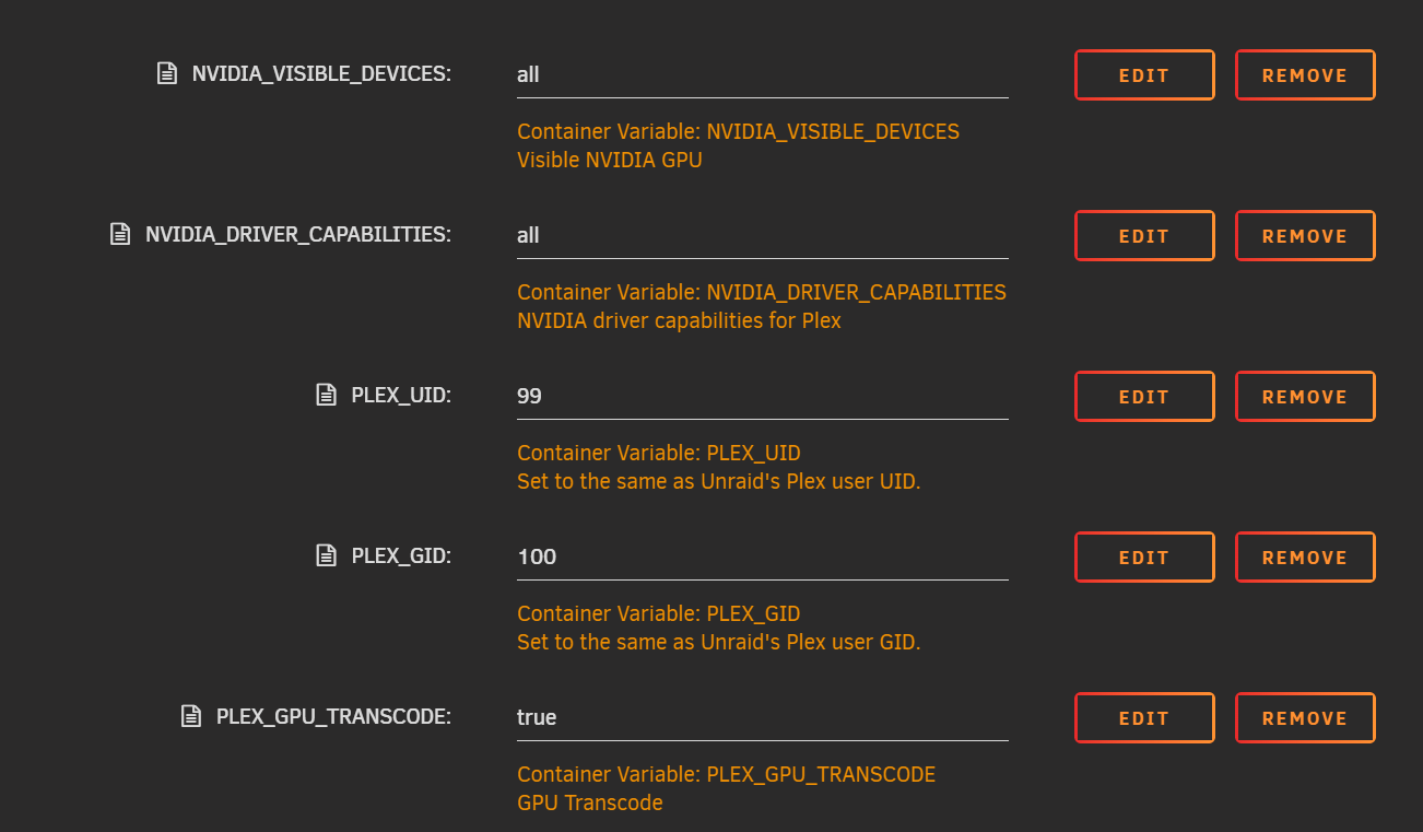

I believe my configuration is correct. I have attempted explicitly providing the docker container with GPU ID this did not work either. I am using unraid 7.0.0-beta.2, could this be a major factor? Or is there something I've missed? If anyone can help an Unraid n00bie ❤️
