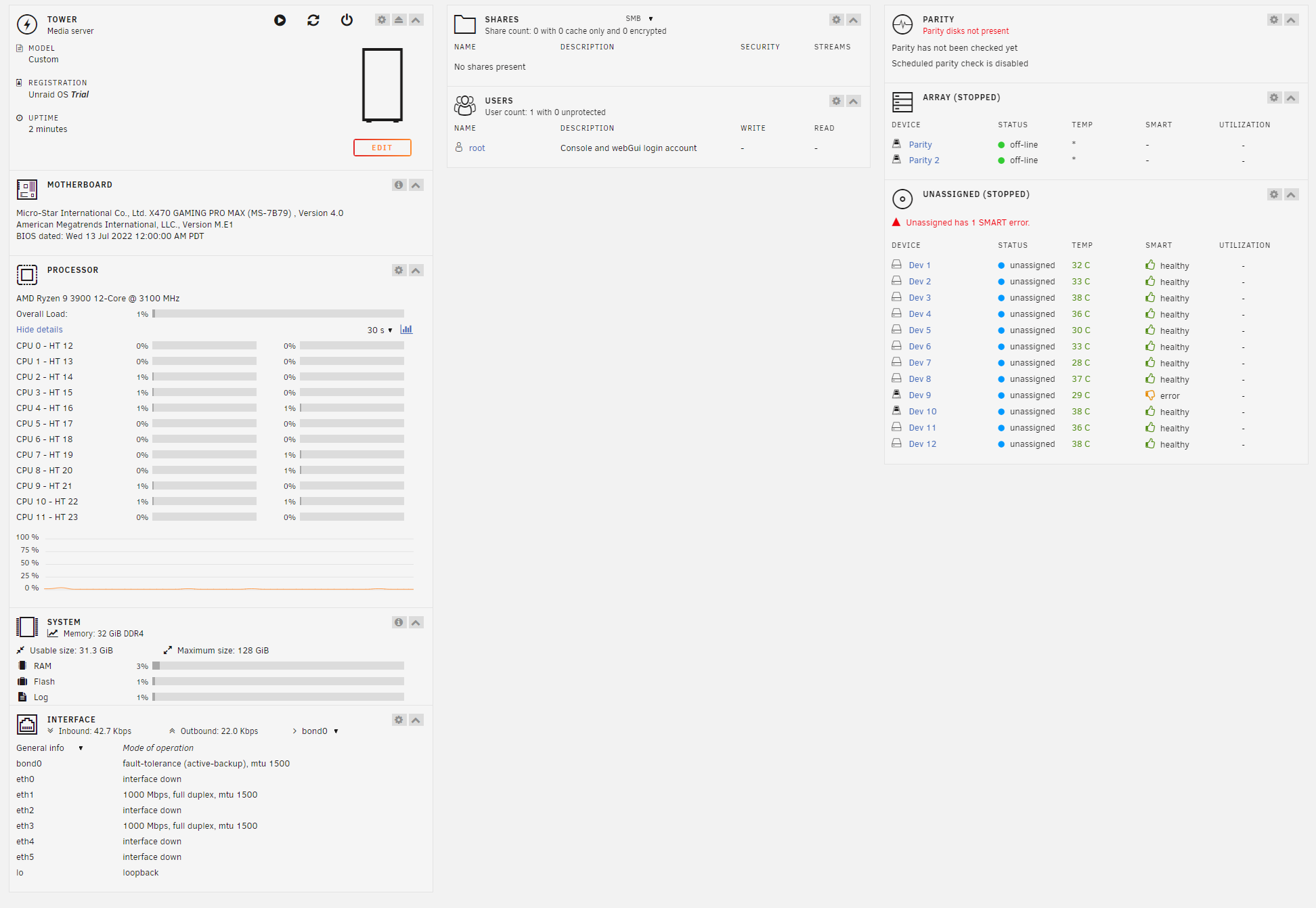

October 7, 20241 yr Author @JorgeB I appreciate your patience. If you look at my next video, I am stuck and I need some guidance. I wish someone could do this for me over a zoom call so it can all be done correctly. https://www.loom.com/share/70e73c8b6c3d4381b932b09abc93b2d2?sid=5347d94b-98b2-4ec4-b046-b22c58f2c83a
October 7, 20241 yr Community Expert 2 hours ago, alitech said: I wish someone could do this for me over a zoom call so it can all be done correctly. You can use https://unraid.net/support/paid-support Regarding your video, you can just ask the questions in the forum, but since there are no assignments, you can't do a new config, just go to the next step.
