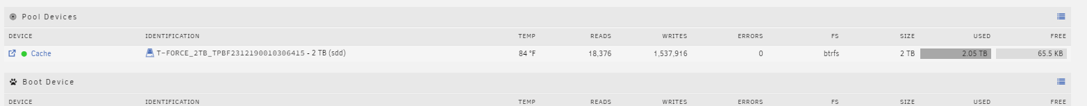

in /boot/config/go and even ran the command manually, but my mover appears broken. My cache drive is 100% full and I cannot write to any shares that are cache -> array .... :(

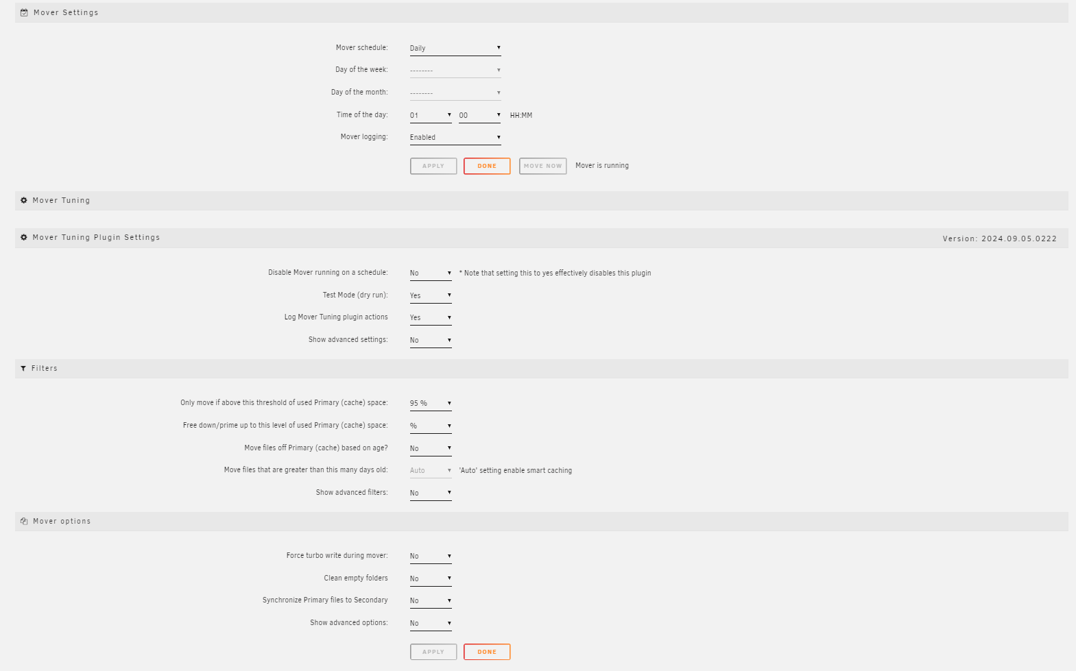

Do you have the mover tuning plugin installed?
Yes.. I even just downgraded to beta 2 and ran a manual move, but nothing's moving.. 65 kb free  on the cache drive :(
Reboot to clear the logs, enable mover logging, run the mover and post the diags, together with the share name(s) you expect ot be moved.

So removing the mover plugin seems to have resolved it...
Yes, that is known to cause issues, and why I asked, but misread your reply, thought you had already removed it.
