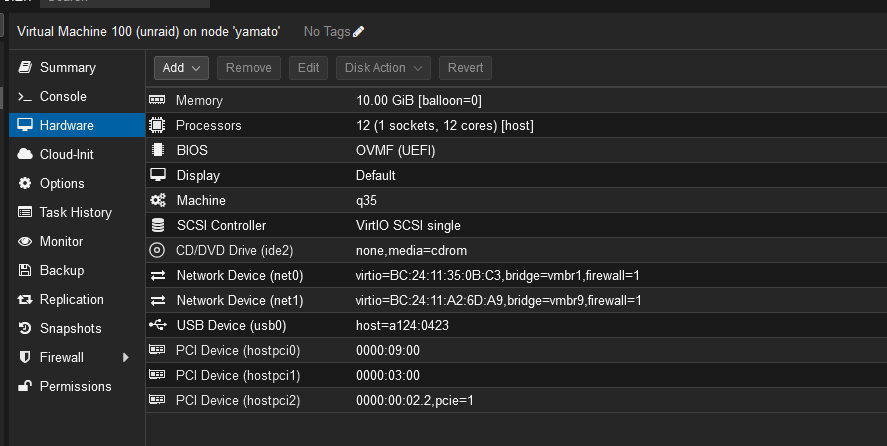

Hi everyone,
Some time ago I:
- swapped from an AMD ryzen 5600G to intel 12400 platform,
- installed Proxmox on it, created a vm, passthrough unraid USB, HBA cards and cache SSDs to a VM to run unraid virtually.
I can read files from my shares, access docker, and manage unraid just fine, but I can't write stuff to unraid any more. Explorer would just show it's calculating remaining time but never start writing.
Diagnostics and vm configuration is attached.
diagnostics-20241005-1640.zip
Solved by JorgeB
If you are using virtio as the network driver, try a different one, like virtio-net for example.
I changed network driver for VM to VMXNet3 and had no problems. Thanks!
