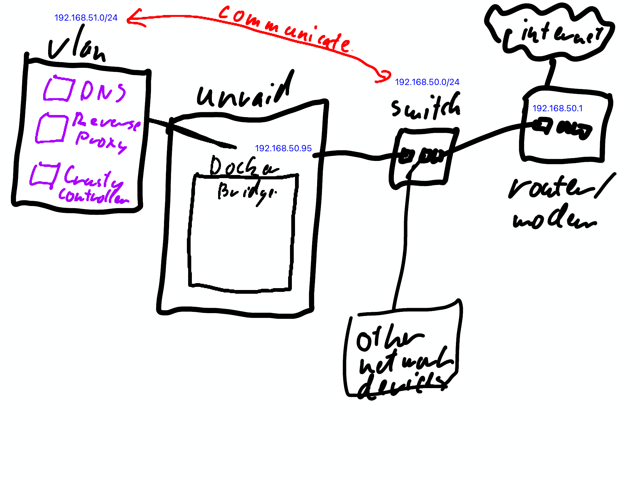

TLDR: How do I set up an ipvlan l3 192.168.51.0/24 that Docker can use in GUI, can communicate with the rest of my network 192.168.50.0/24 and the internet. Possible configuration problems because of previously created networks.
I am having a configuration problem. I want to be able to play modded minecraft with my sons with as few headaches as possible when setting up a new server. We have been using crafty controller in docker running on the bridge network which has been fine for 3 servers but now they are asking for other mod packs and I am seeing a future of trying to keep track of many servers at once. I want to make it easy to connect a new server (or an old one if one son wants to join a modded world that has already been started with the other later). Each server runs on a different port on the same IP. I want to be able to direct them to a domain name for each server. i.e either 'ATM9.lan' or 'ATM9.minecraft.lan' instead of 192.168.50.95:25595.
Through research my understanding is that I need a 'DNS server' to direct the domain name to a 'reverse proxy' that then connects to the correct ip:port of Crusty's server for that particular modded world.
My first stumbling block has been setting up a separate Vlan for these three docker containers (So each container has its own static IP address and I do not have to worry about the DHCP server on the router assigning arbitary addresses or double assignment when things are reset).

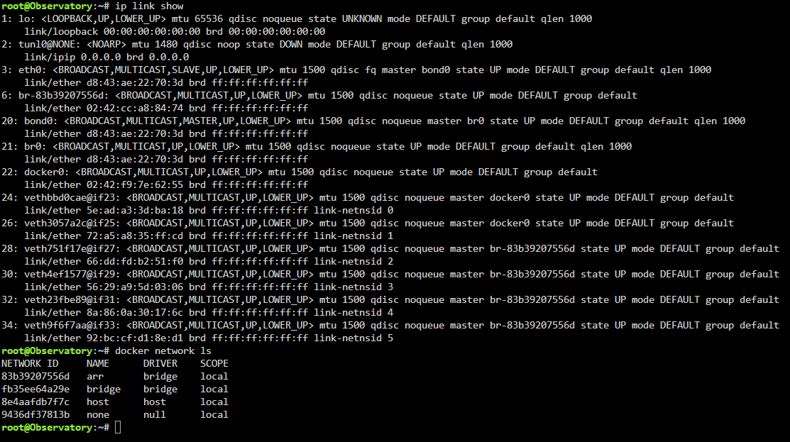

  • Created a Vlan but it couldn't be seen in the docker GUI.
  • I have had docker refuse to create the VLAN because the parent device was already in use.
  • Created the IPVLAN but couldn't start a container because the host device already had an IP.
  • The IPVLAN was started had a container working but it couldn't communicate/ping with anything else on the network or the internet, and other devices couldn't communicate/ping the container even though there is a static route defined in the router.
What are the steps or order of commands and what should be my commands 'ip','bridge', 'docker network', etc.?
