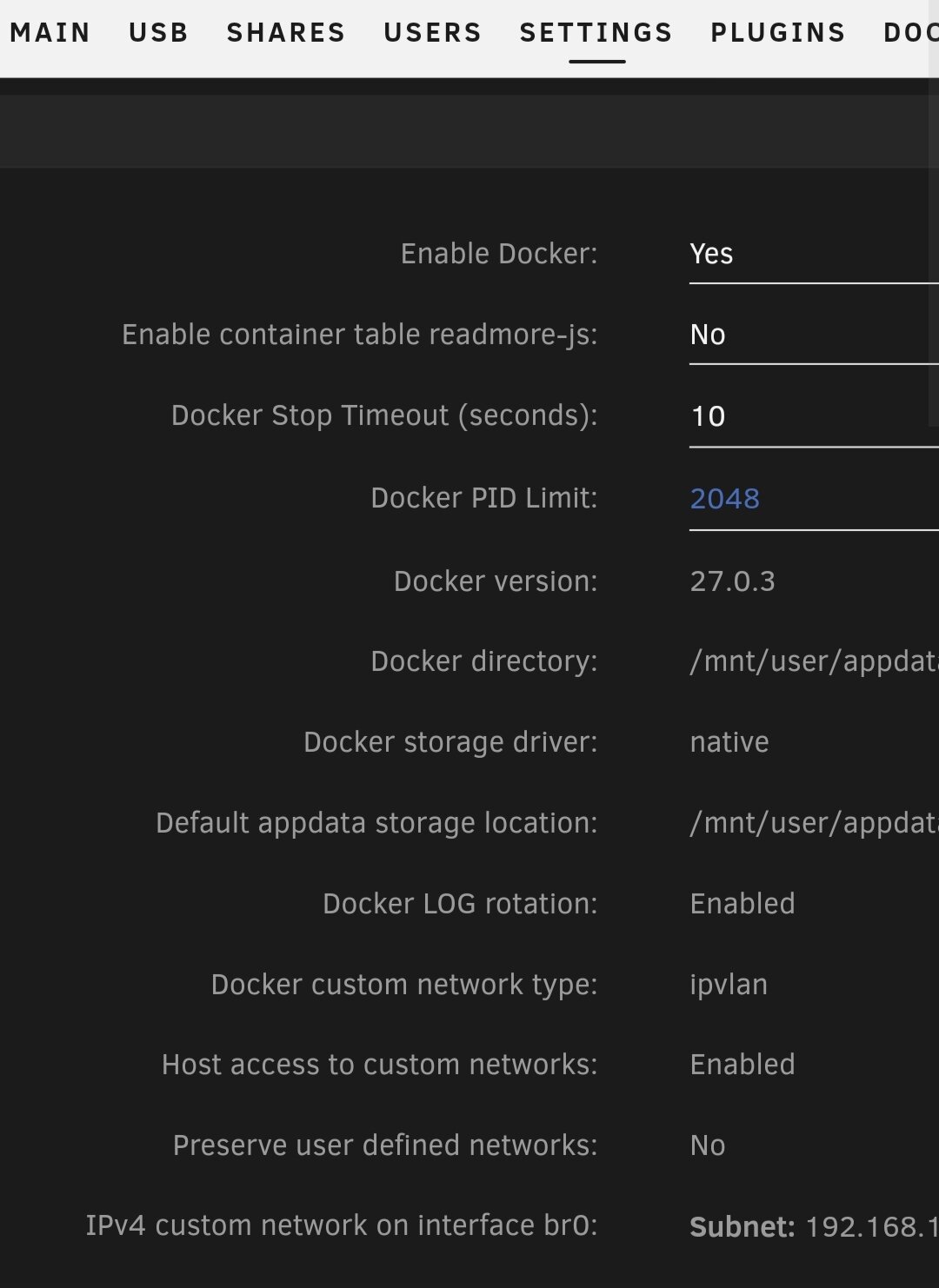

Don't know if it can help, but here's how my settings look under setting>docker.  I can't read into the logs well enough to spot your problem.

Are you able to change your host access to custom networks to enabled?  I know docker uses their own network and maybe it's related
OK. i have done so, and restarted docker service (but not full system reboot) - seems to still be stuck..
