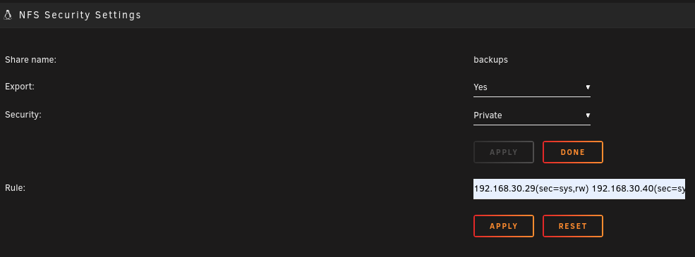

So I have a couple of Proxmox servers that I want to SECURELY back up to my Unraid server.  I have had no luck using SMB at all, and only been able to get an INSECURE setup using a public NFS share.  I tried:
Setting up NFS private and also secure and I get 'permission denied' errors when I try and backup to this share.  The rules are for the 2 IP addresses of my Proxmox servers.  I tried changing the owner to 'root' since I'm running as 'root' in Proxmox and also tried 'nobody\'.

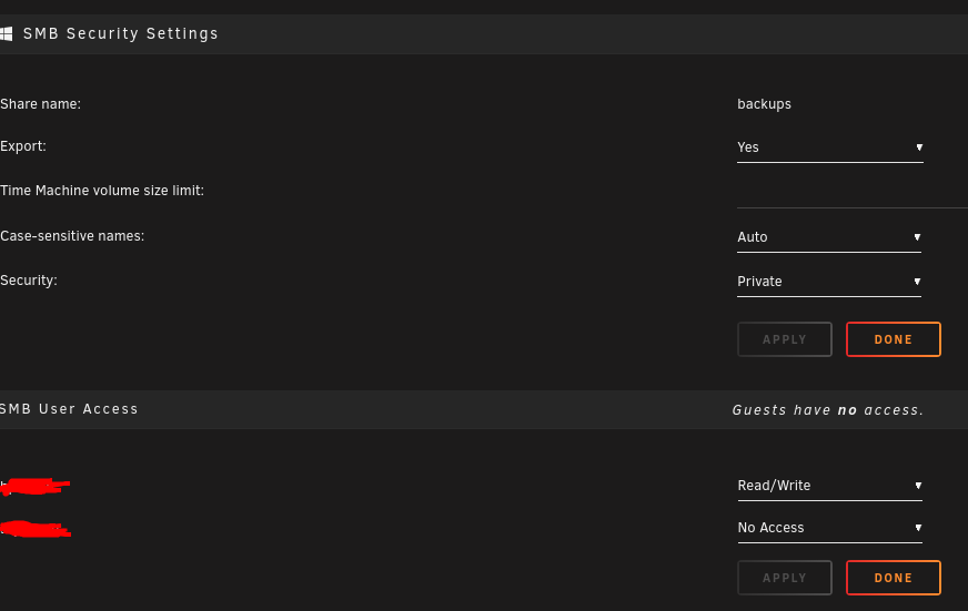

For SMB I tried Public, Private, and Secure and none of that works.  I triple checked my credentials but it makes no difference, despite being able to mount and unmount the share from Proxmox without issue.

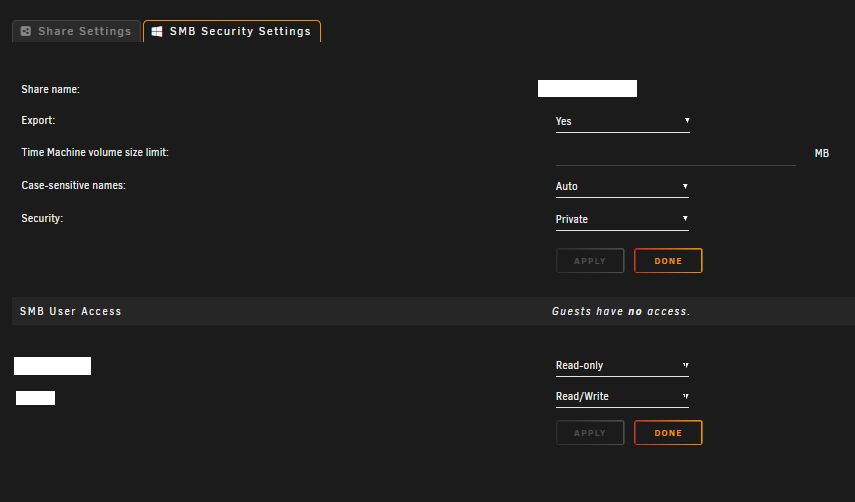

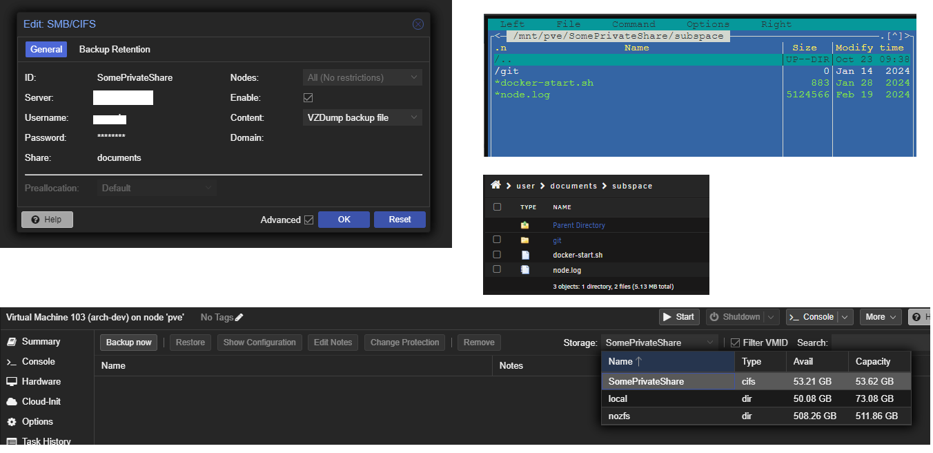

Working fine with this test SMB share I setup

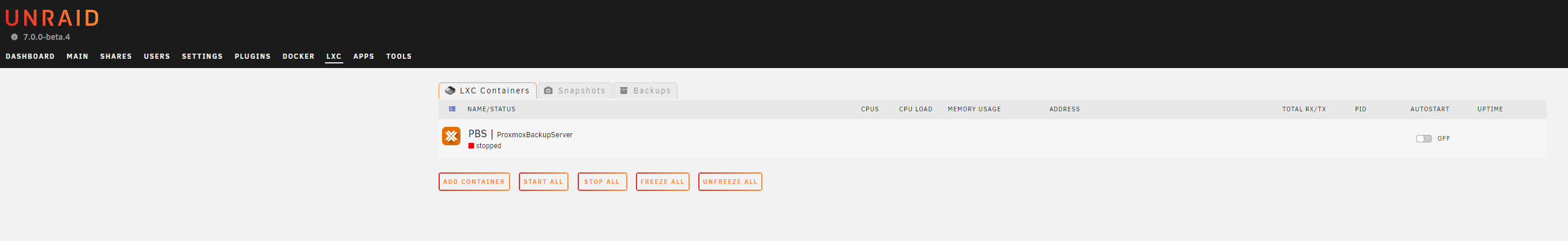

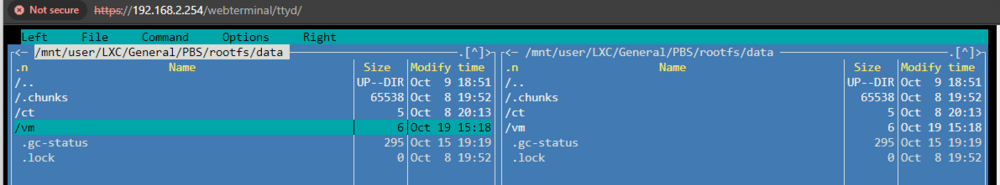

? lxc pbs system
docker pbs system

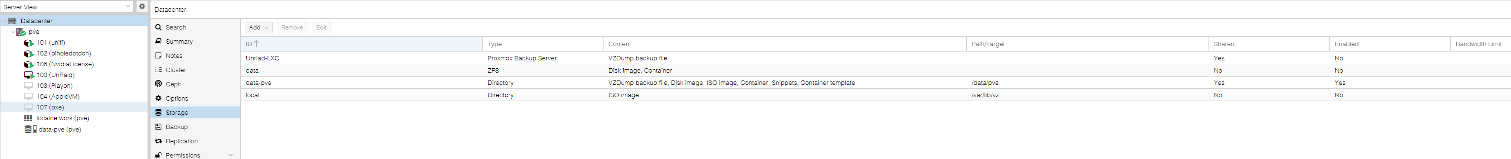

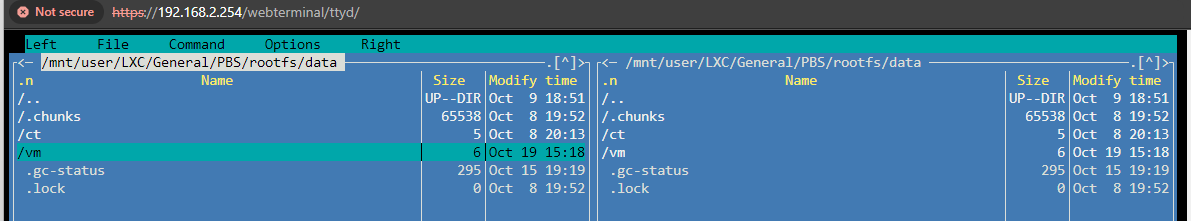

https://www.jdbnet.co.uk/install-proxmox-backup-server-in-an-lxc-container/
This is waht i do
you can even add a smb share in proxmox.
so open shell make a director i used /data
then mount the data location in unraid.
so going to /mnt/data is now unraids /mnt/user/proxmox
*Edit fs tab to add auto mount...
then go to data center > storage add Directory chose /data
or just go to datacenter and click add smb / nfs and fill out the prompts...

I can create SMB and NFS shares with security and Proxmox doesn't have an issue using it.    The configuration of Shares on Unraid is pretty straightforward and I included the configurations so I'm not sure what else I can check.
With what security settings?
17 hours ago, bmartino1 said:
? lxc pbs system
docker pbs system
This is waht i do
I've done all of that and the mount will only work if the share is public.
so you want nfs rules to make a private share
this would be the private rule...
192.168.x.x(rw,sec=sys,insecure,anongid=100,anonuid=99,all_squash)
^ as this uses what the public sharing is using to work but only apply it to one and only 1 ip address...
Edited by bmartino1
Thanks for that.  Unfortunately, I have multiple servers I want to back this up to.
then make another private rule under that one with the ip address of the servers.
this way only server you made a "public" Private ip assinged rule can securly access that share.
192.168.x.1(rw,sec=sys,insecure,anongid=100,anonuid=99,all_squash)
192.168.x.2(rw,sec=sys,insecure,anongid=100,anonuid=99,all_squash)
Private
Given you were originally trying to do this manually in the CLI, I think the mount folder had incorrect permissions.
The GUI does this automatically.
Edited by tjb_altf4
I only created the Proxmox mount in the CLI after adding the remote share in the GUI didn't work.

When you write "under", I don't seem to be able to do that.  Can I not just comma separate the rules?
shift enter
space separate per other nfs forum thread.
I had 3 at one time.
