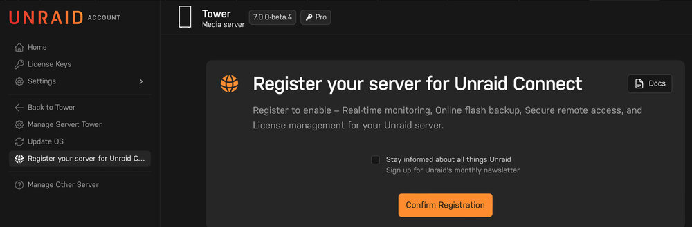

Hope someone will be able to point me in the right direction, as to what I'm doing wrong. I have my basic key installed and server working fine. Running on 7 Beta 3. When I go to unraid.net and try to register server for unraid connect, I get the following error:
The system then shows unregistered until I recover the key again, which works fine. The key is there in the config directory fine.

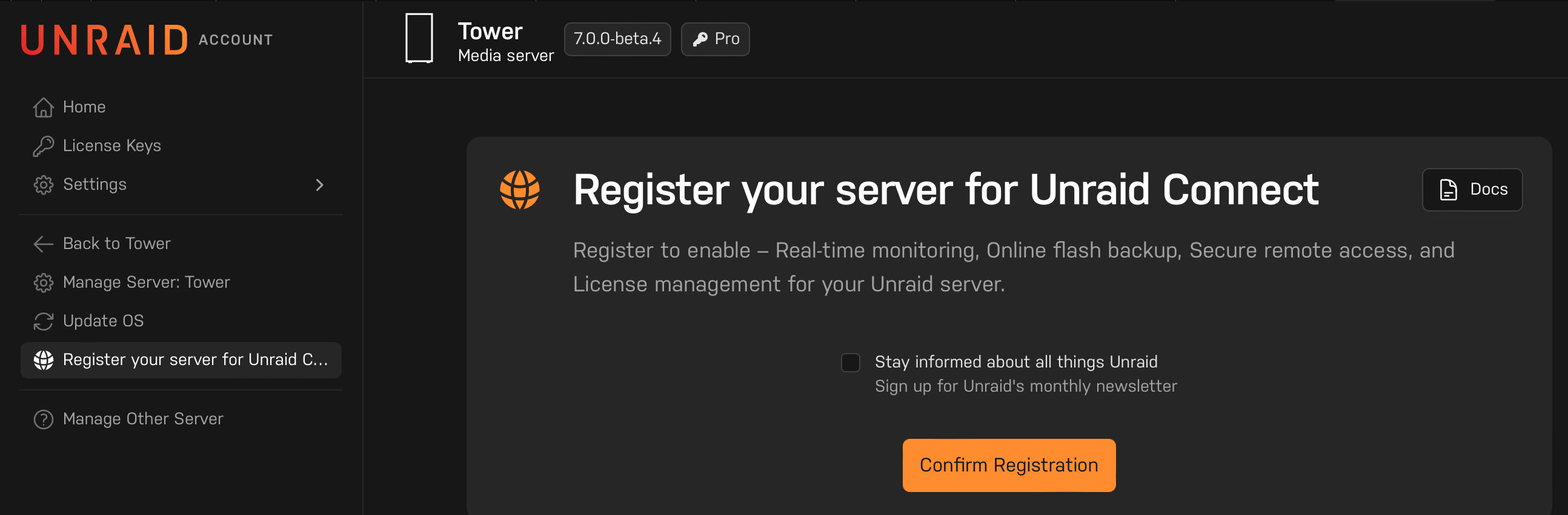

Hi there, I don't think you're doing anything wrong. I was able to recreate your issue.
I just released the change to our Register for Connect page that should hopefully sort out your issue.
Please try once more and let me know if it works.

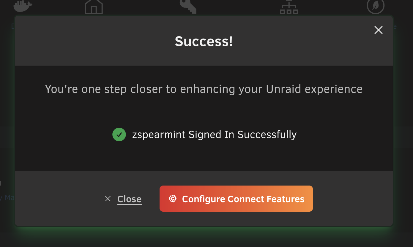

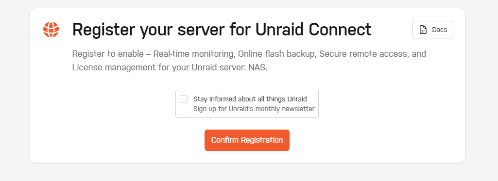

You should see a success message like this after registering –
Then click the "Configure Connect Features" to get going with setting things up.

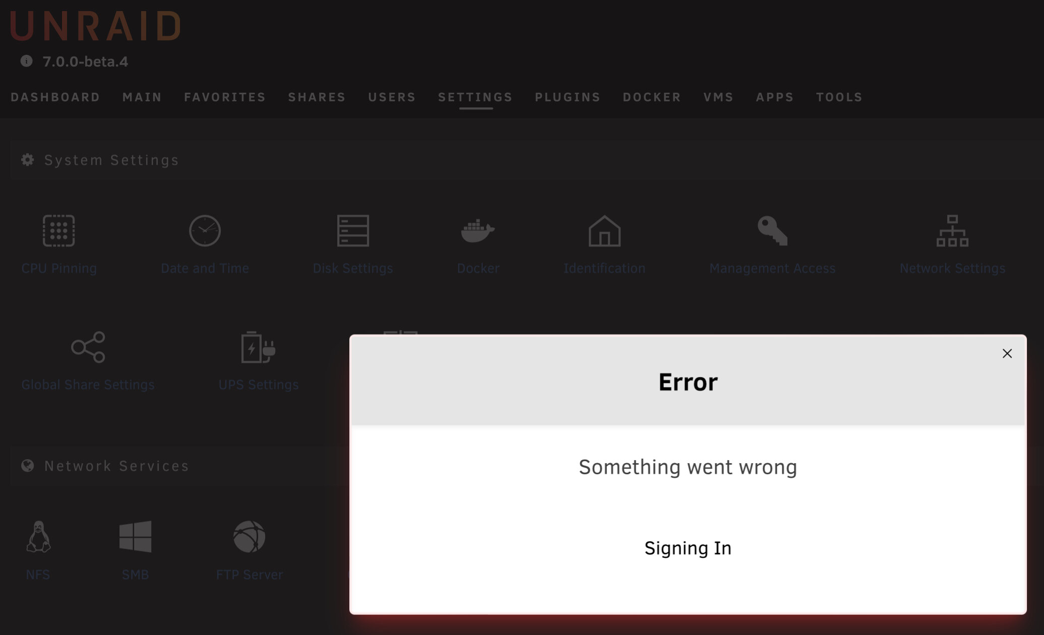

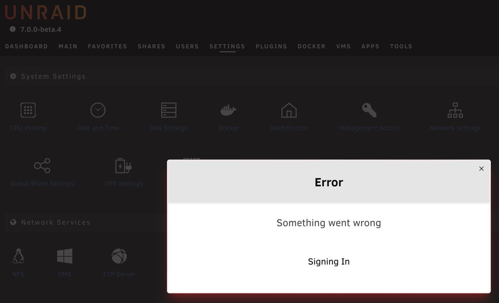

Thanks for the quick reply and help. I have tried again and I get a different message:
Nothing reported in the logs on my server.
Thanks
Update: Rebooted and seems to be working now, thanks. Will test further later today 🙂

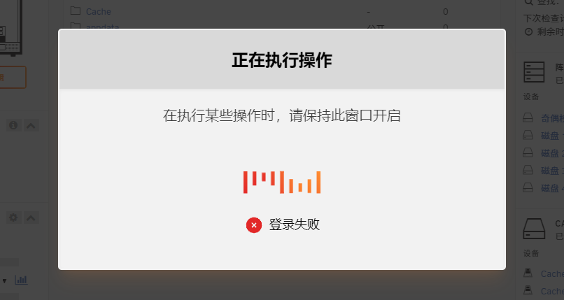

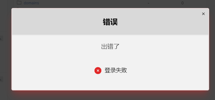

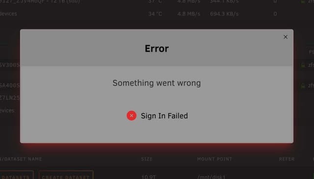

我的界面是这样的。这问题从2024/10/19开始发生的。

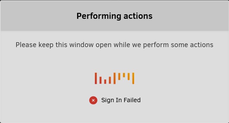

Facing the Same Issue
Can not add Server to Unraid Connect
IMG_4824.thumb.jpeg.97f8faf24badac164a0cc715560501f4.jpegIMG_4823.thumb.jpeg.18eae9ae4df955fa5bb3736783ee93ee.jpeg
