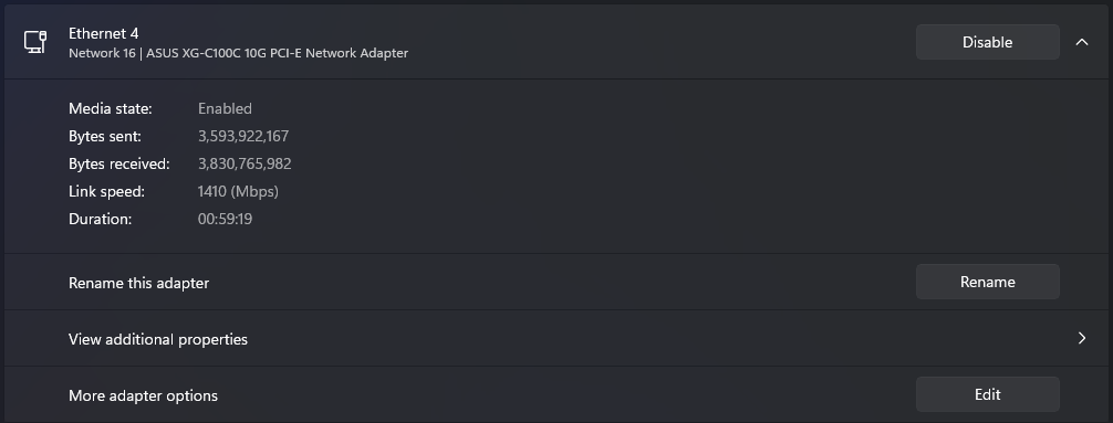

I've tried on an MX500, a Samsung 870 EVO and even my Intel Optane P1600X. Same speed on all of them.
It's mostly a consistent 180MB/s. If anything the slight slowdown is right at the beginning of the transfer.
I attached a window screenshot of what a typical transfer looks like.

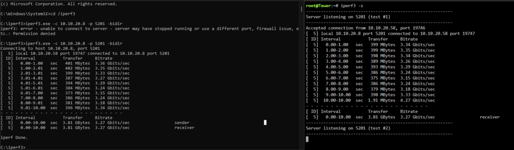

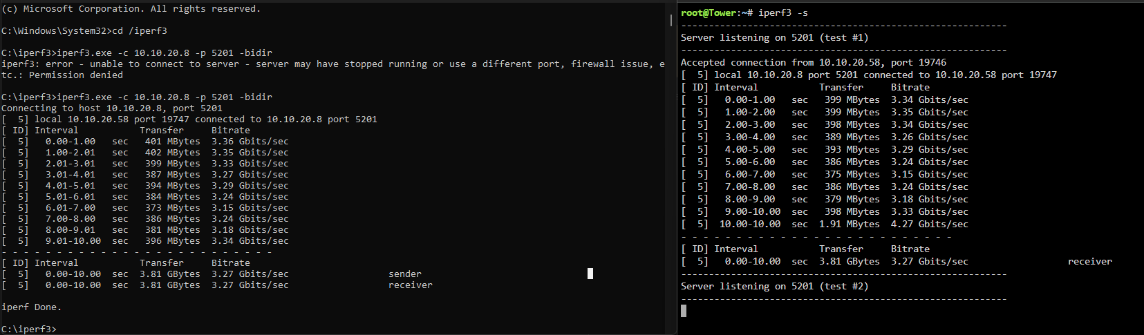

Have you done an iperf3 test between the two machines to determine if the network is achieving 10G speeds and is not the bottleneck?
Attached images.

That's pretty low, you should get close to line speed with iperf, it only tests the network bandwidth, no devices involved, could be NICs, cables, switch, client PC, etc.

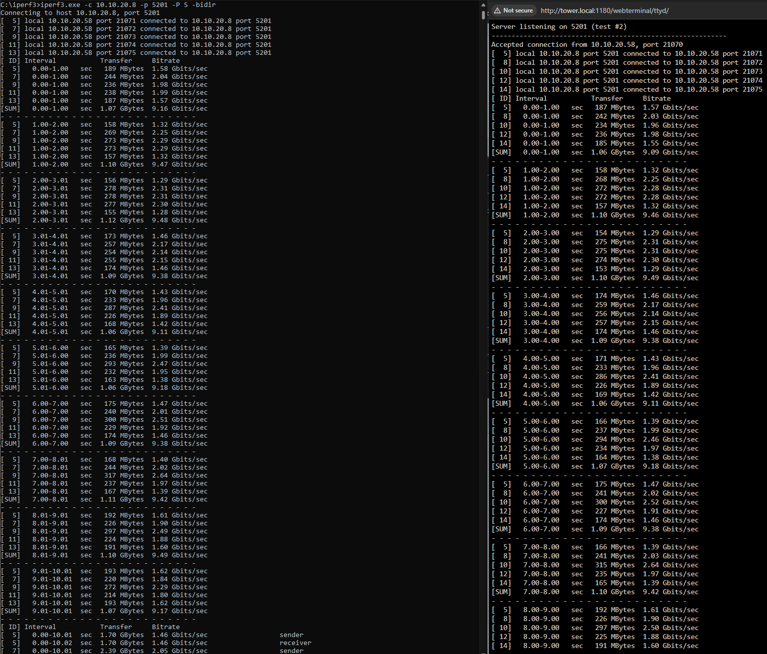

Someone elsewhere directed me to run iperf with 5 parallel threads, and it looks like it actually saturated most of the 10Gb.
So I'm assuming the problem lies somewhere in configuration.
That's not a good test, a single thread should give you close to line speed, unless you will be doing multiple simultaneous transfers, then you should also get a better speed.
But at the very least it proves both my NICs and cable are capable of near-10GBe output? Like, my PC motherboard's 2.5G NIC can't replicate this.
Yes, but for a single transfer can still be slow, unless like mentioned,
