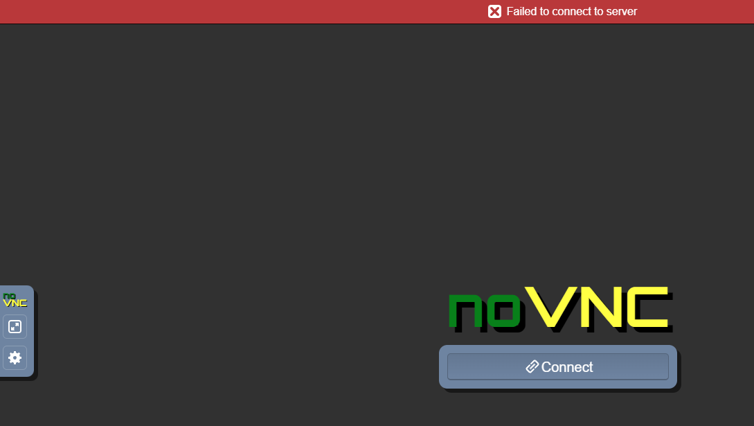

I don't know what changed but suddenly all my VMs and even new VMs won't boot after installing a 10Gb NIC card and a Graphics Card into my UnRAID PC.
I've tried to install several Linux distros but none seems to work. The VM says it has started but VNC can't connect.

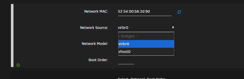

Looks like the VM is trying to use virtbr0 but you dont have bringing enabled. Change the VM nic to you the vhost interface. network source
Hi Simon,
I've tried both vhost0 and vhost1. None seems to work.

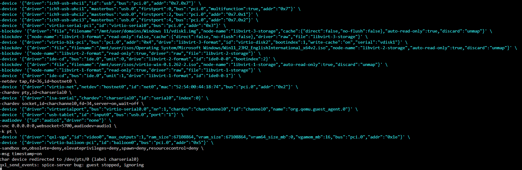

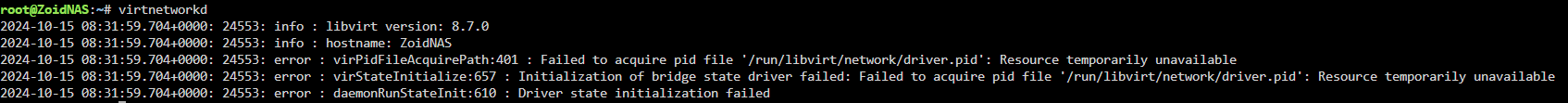

Hi Simon,
I've already backed up all my VM's and deleted them all in UnRAID to start from fresh.
Then I've moved the libvirt.img as indicated.
Started VM Manager again. It created a new image file for libvirt.
And I've tried to create several VMs (Windows and Linux). But all of them doesn't connect with VNC.
This is the Windows VM log:
I just don't know what else to do!
