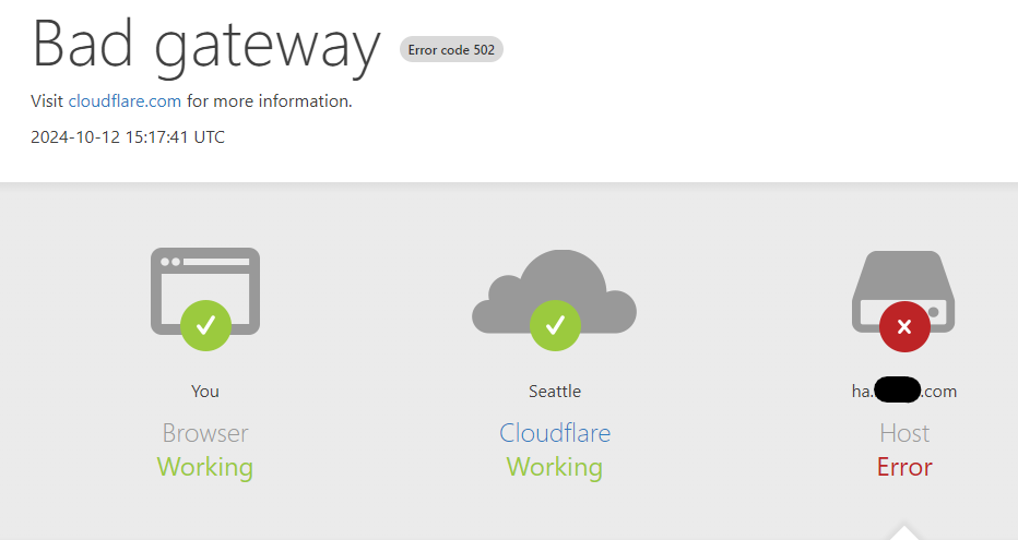

That definitely did something. My homeassistant unraid docker log is now empty. Now I'm getting a 530 error when I hit the url.
cname setup in cloudflare pointing to my duckdns account. Works swimmingly for other services.

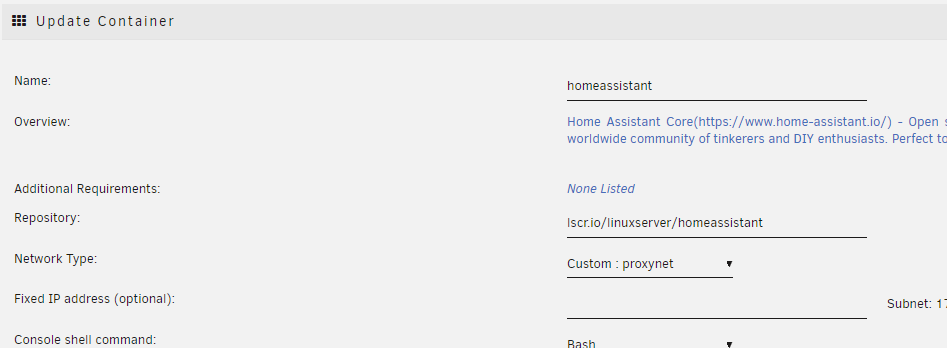

The docker settings, I do have it setup under "proxynet" for a different Network like this:
I tried changing the Network Type: back to Bridge, no changes to the 502 error.

So that's slightly different. But after dinking with all of those, I'm still getting the 502 Bad Gateway error above.
So: progress, but still stuck.

Both NPM and Homeassistant are on custom network "proxynet"
