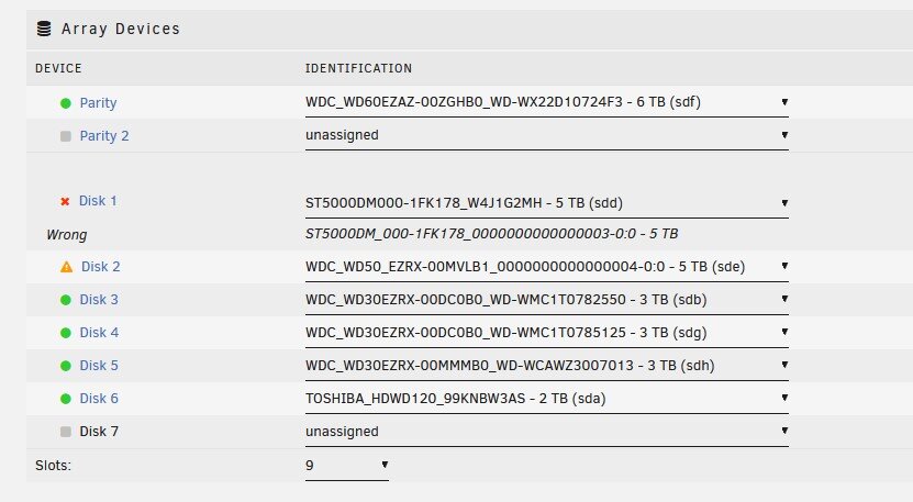

Problems with Disk Configuration
I have a problem with my Unraid System. Currently I'm running the 7.0.0-beta.3. My Problem is, that my Disk 2 suddenly was "offline". So I took the whole array Offline and re-added the Disk2. And Unraid started the Rebuild Process. But it was slow, like under a Megabyte/s. Then I restarted the whole system and now I get this result. My 5TB Seagate Drive isn't recognized anymore, because the identification of the drive changed somehow. And Unraid says, that this is a wrong drive. On the other hand, I also can't reset the configuration and re-add the drives, because I have no idea of the state of the Disk2 and it's rebuild process. Is it somehow possible just to change the identifier of Disk1?
