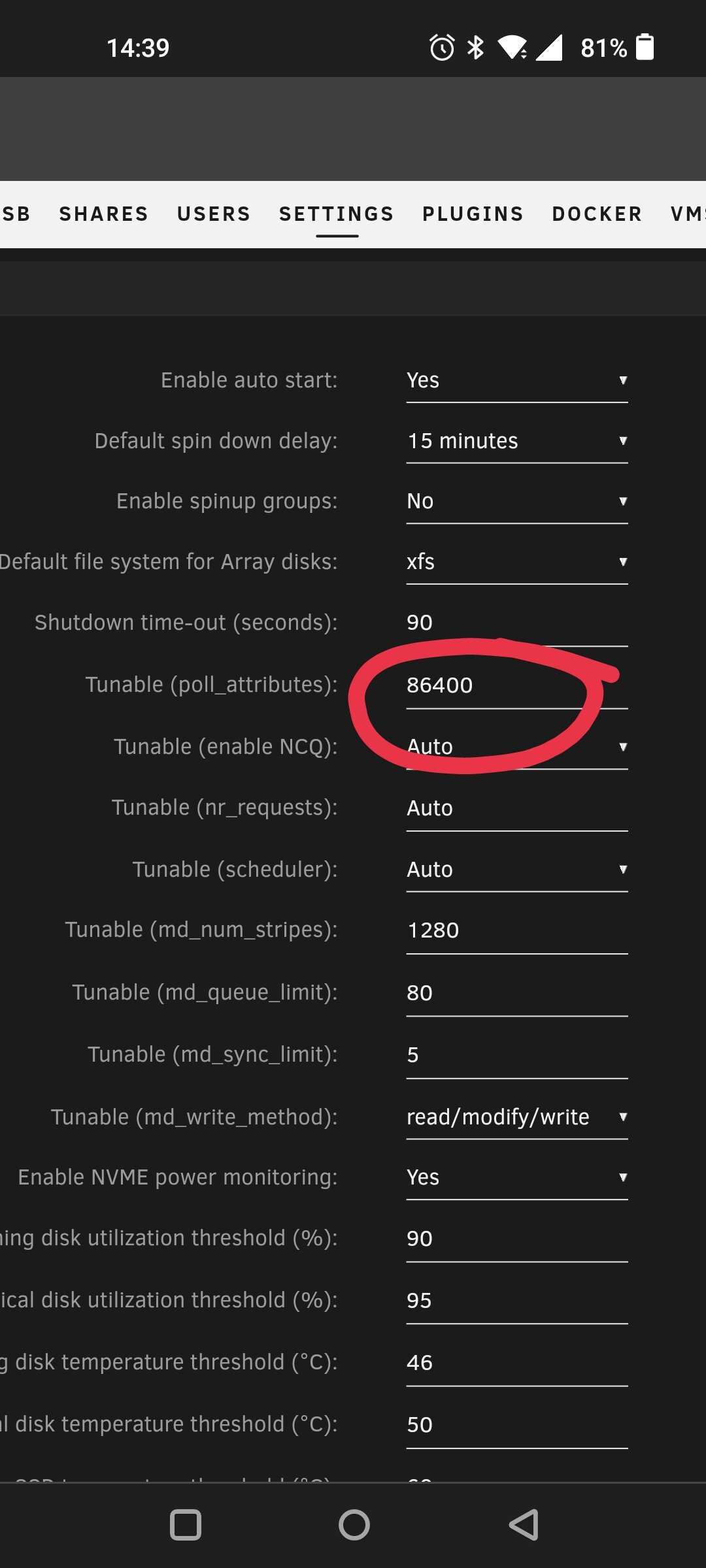

Try this.  Had something like yours trouble me a long time til I found that setting.IMG_20241012_144006.thumb.jpg.c47de91c55e764553bfa3cd781d3e301.jpg
OMG thank you so much! i hope this helps... just implemented... I'll report today whether it has done any good
PS: If this is the solution... Is it possible to increase the value? because querying all 24h SMART values is too often for me because some of my drives are in spindown for weeks...
Edited by #Tobias
No success... despite the new setting, the disks started up again approx. 4-5 minutes later after spindown 🤥

Mine was weird too.  Kept getting Svr emhttpd: read SMART /dev/sdg on just some drives.  That timer in the setting above changed it to a 24hr query.
Edit: never figured out why it was just some drives.
Edited by Veah
