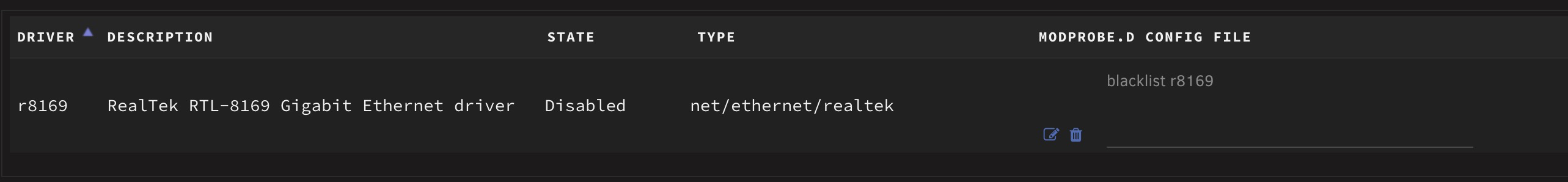

The r8169 driver is being blacklisted, delete /config/modprobe.d/r8169.conf from the flash drive and reboot.

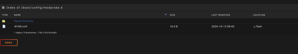

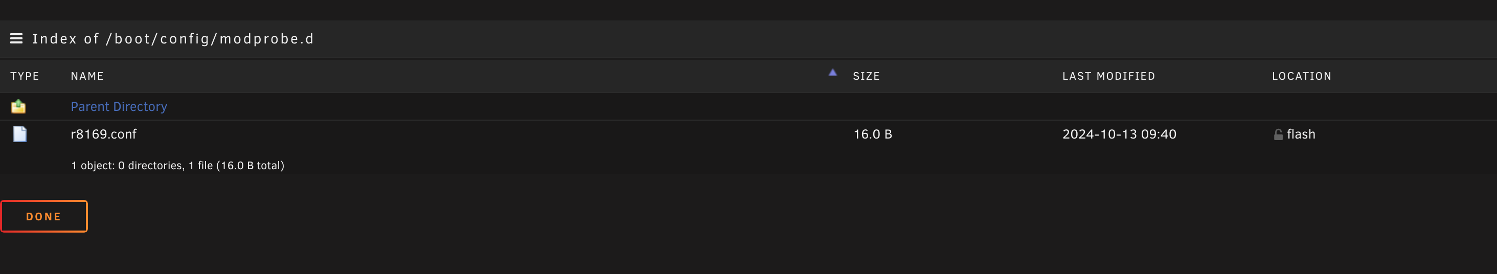

However, it appears that r8169.conf re-installed itself, so after my second reboot i got the same issue again and had to delete the file again. Is there a way I can prevent that driver from being installed?

You could try deleting the "unraid-r8168" plugin and rebooting in case that is doing it.
