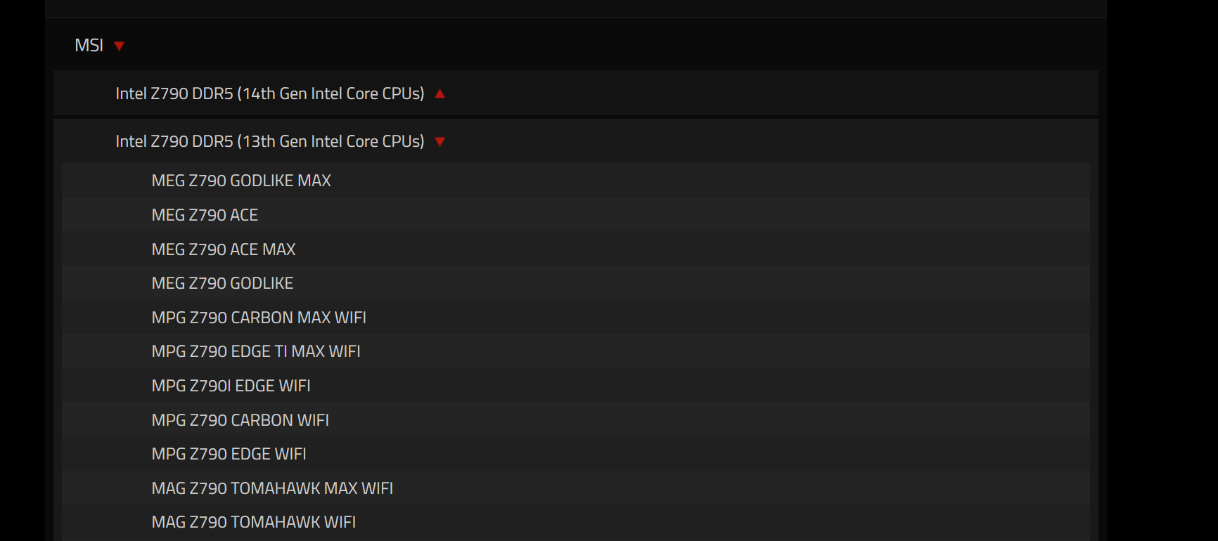

So a general question for those more in the know on recent hardware developments than me. What is the deal with the seemingly random incompatibility claims? Intel ARK says my 12th gen CPU is compatible with DDR5 up to 4800MT/s. But if you look at corsairs site for the kit I bought they claim it's only compatible with 13th gen Intel CPUs or newer?

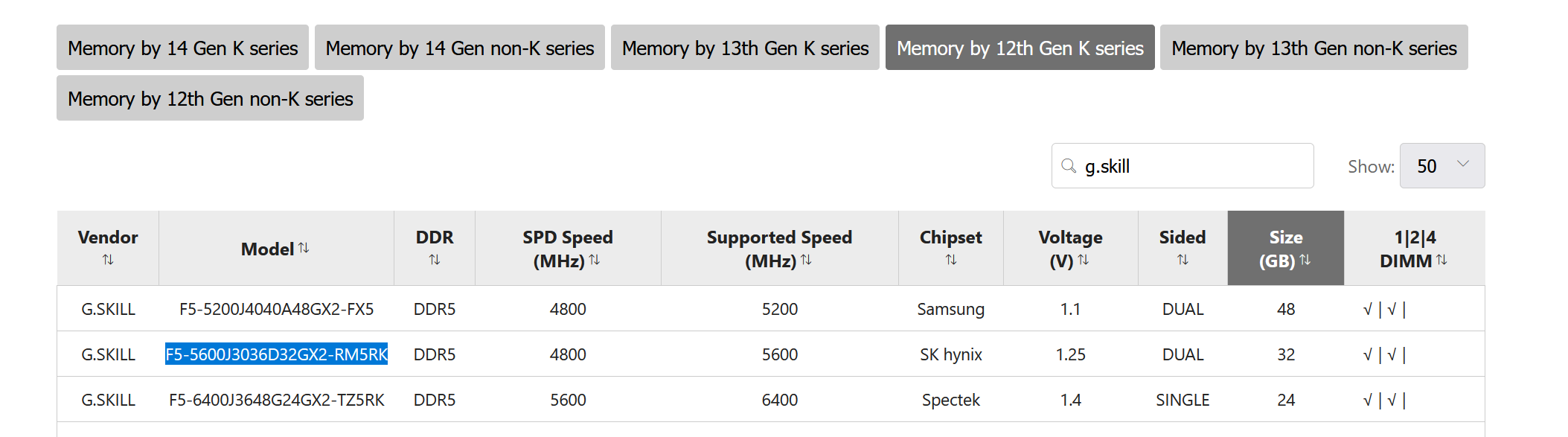

I'm looking at a G.Skill kit (F5-5600J3036D32GX2-RM5RK) from MSI's list and its the same thing, my mobo is on the QLV list but ONLY for 13th & 14th Gen CPUs.
But if you go look at MSI's QLV for my mobo, it lists that exact G.Skill Kit (F5-5600J3036D32GX2-RM5RK) as compatible with a 12th gen K series.
So What's the deal? Why do RAM makers seem to be much more limited in their compatibility claims than the mobo maker and intel are?
Then I've got kingston over here (KF556C40BBAK2-64 another kit off MSI's QLV list for 12 then CPUs) who makes absolutely zero compatibility limiting claims either on the product page or datasheet for that kit. So who do I trust? Am I just going to have to go kit by kit and check my Mobo/CPU combo compatibility against every single kit i look at?
