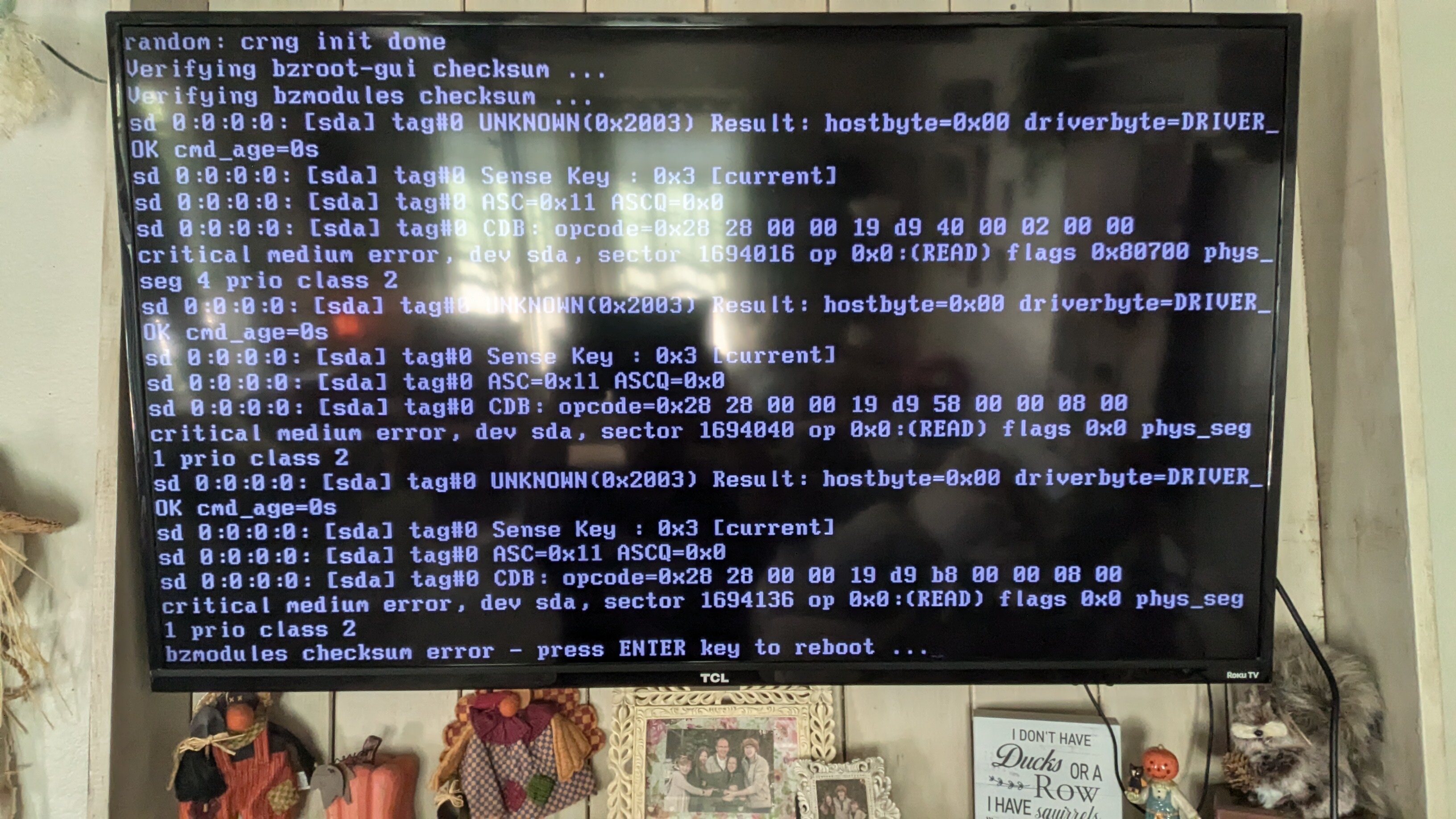

My system did an update yesterday and now will not boot.
After about 7 trys got it to boot past the boot screen to this error
bzmodules checksum error press any key to reboot.
See attached photo
Please help, I'm thanking my usb drive is bad.

Looks like your files may be corrupted.  Have you tried putting you USB into a windows computer and see if it detects errors?  Do you have a backup?
You may need to download the software.  You can do that from here:
         https://docs.unraid.net/unraid-os/download_list/
Most of the time when this happens, only the download files are corrupted.  So unzip the download and copy over all of the  bz*  from the root of the zip file to the root of your boot drive.  (overwriting any existing files when prompted!)
well after many hours of troubleshooting (actually only 1 hour 😁) I came to the conclusion that my system crashed during the update! looks like the CPU fan failed and my system shut down during the update causing the drive to become corrupt. this is not the worst of it I also lost the M/B and 2 SSD's in the process. so all to gather 1 CPU fan, 2 SSD's  and a M/B. WOW🤯.
Luckily I had my old media server sitting on the shelf out in my storage, that's what I used to troubleshoot my system, so I dusted it off, put the CPU, memory and drives that are left in it, got the pool rebuilt and it is now finishing up the updates. I'm glad I kept that 7 year old system 😆.
All good to go. thanks for the input
