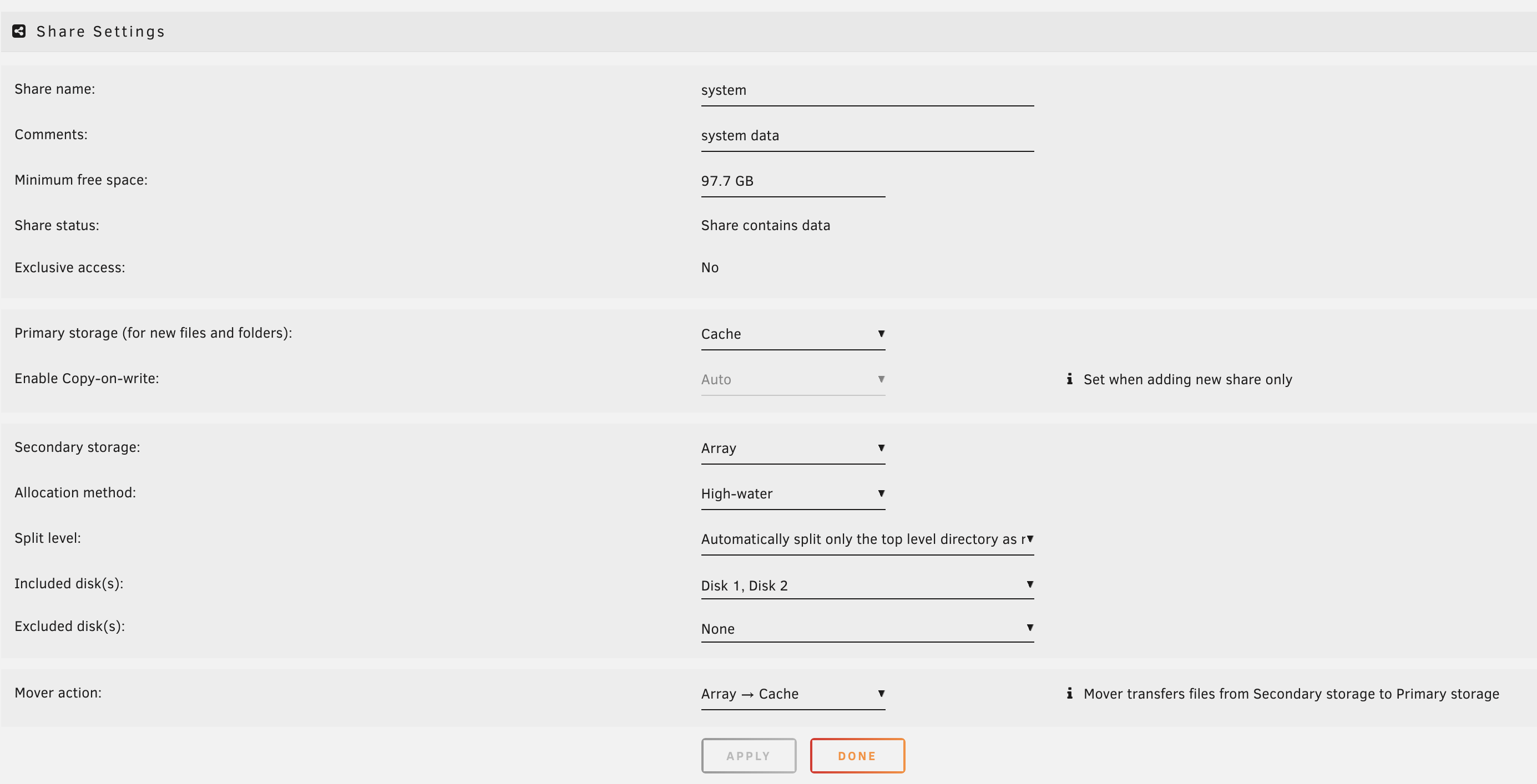

October 14, 20242 yr I am having trouble with appdata and system folder files being moved off the cache and on to the array when I have the following settings: Are these not correct to have the files kept primarily on the cache? I also have and use mover tuning as well. unraid-diagnostics-20241014-1136.zip Edited October 14, 20242 yr by Brenex

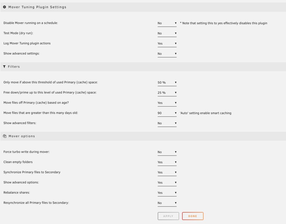

October 15, 20242 yr Community Expert Solution Settings are correct, try uninstalling the plugin and retest.

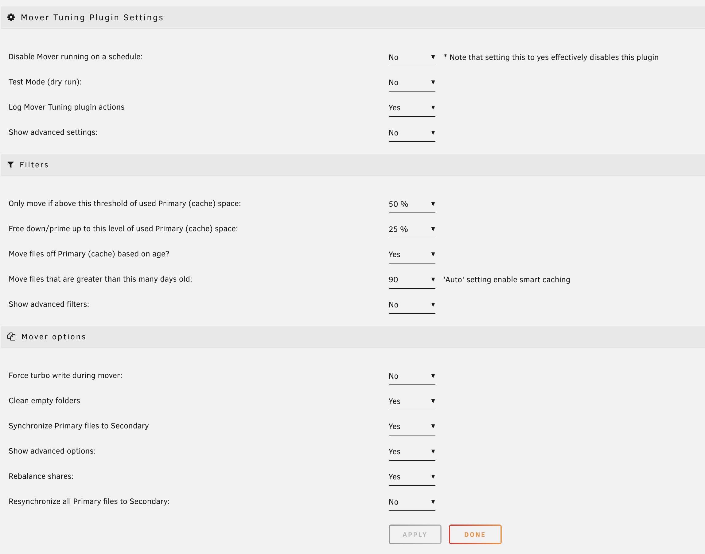

October 15, 20242 yr Community Expert In case it is not clear I think that @JorgeB is referring to the Mover Tuning plugin which is shown in your screenshot. It has been known to cause problems with mover in the past.
