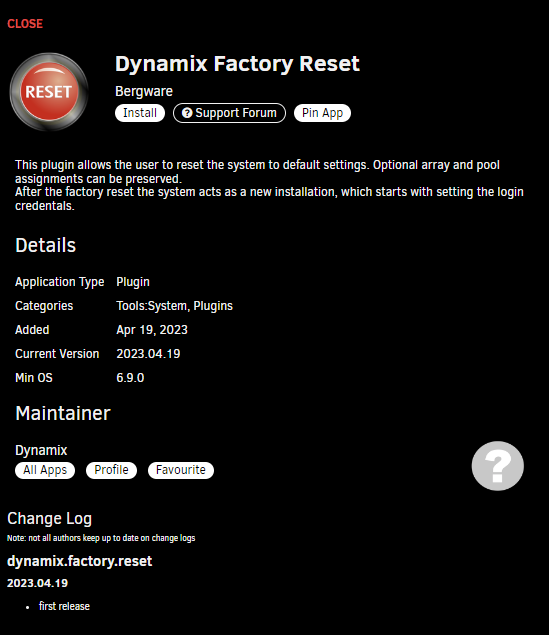

I would always take a backup before starting, and make sure your encryption keys are safe also... but there is a plugin to do just this.
