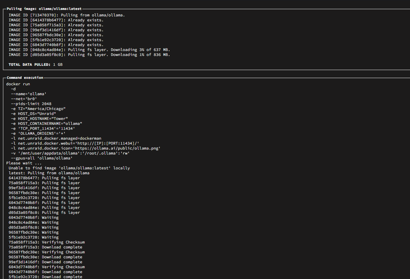

I have been trying for a few days now and having no luck at figuring out why I am unable to install any dockers.

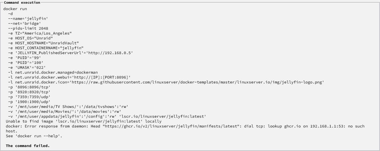

This is the type of error I get. And when I update it says the docker was successfully updated but it never fully downloads the update. I tried changing my DNS settings. I’m on college Internet.
This screen stays up indefinitely sometimes, but occasionally, after an hour will successfully install the docker, but without the most recent version. And when I go to update, it will update for about 30 seconds and say it successfully did without actually downloading the entirety of the update. This is happening to all my dockers.
I’ve reset the server to factory, and all data is in the cache drives. Any help would be greatly appreciated.
I am on OS version 6.12.13.
That worked! Thank you so much.
Can you explain what that did, though? Or is that above layman level?
It suggests your router/ISP has a DNS issue.
