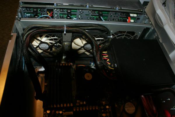

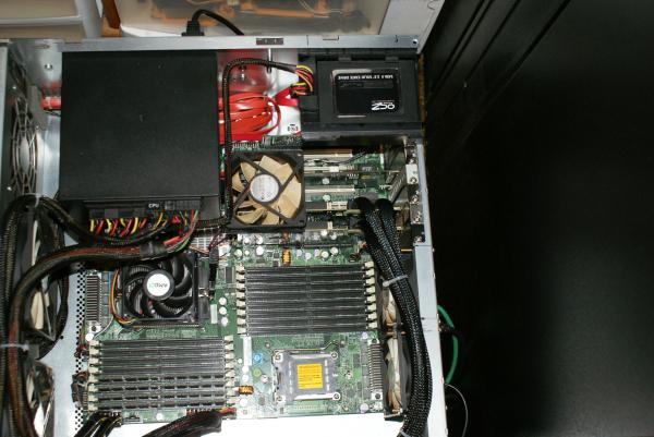

Here's a few pics of how I made mine work for me...
Brilliant! I just may have to copy your setup. I assume its WAY quieter than before since you don't have the 20mm fans on the power supplies spinning like they're ready for take off? Yes you do lose the power supply redundancy but since myself and probably everyone else here runs a UPS its a non issue. Thanks for sharing.

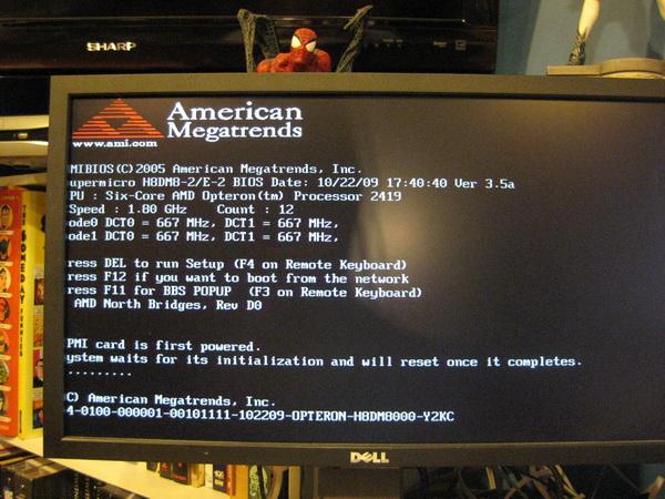

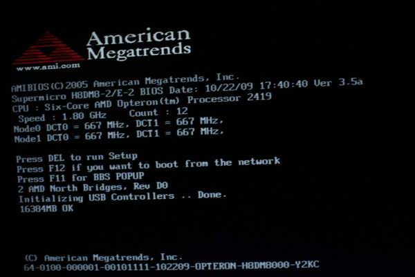

Hi guys, now rockin my 12 cores!  thanks to bigdady, trajik, and everyone else on this thread for their help!
Now... what to do with them... ::):P

Hey Mike... Did you mod your server case to use a single power supply... Were you able to make it silent?

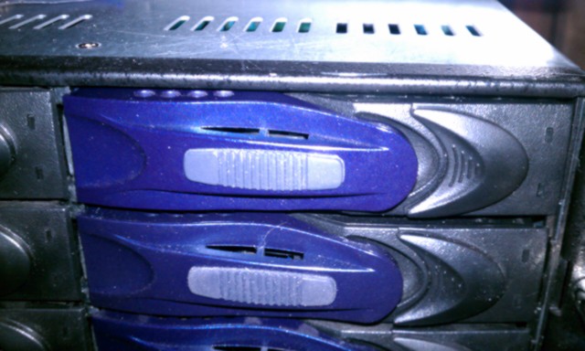

Hi folks... I spoke with someone at Tamsolutions on Friday... no more AMDs... but I was curious... do these servers have drive activity lights?
Someone from Tamsolutions replied to my email inquiry by saying :
We have these with 2 different types of tray styles, the style that is not pictured does have activity lights on them.  These tray styles are available in both the 1.86ghz and the 2.0 ghz
Does anyone have pictures of what the drive bays look like that have activity lights?
So it looks like I am going to have to go with one of the Xeon models... since this server will only be used to serve DVD/BD/Flac data to my Dune Media Player... is there any reason to go with the 2.0 over the 1.86?
I'd also like to know if anyone has tried using 4TB drives... like the new Seagate GoFlex 4TB?
Thanks... I am excited to get one of these!
I have one of the Xeon 2ghz models.  My trays have power and activity lights, but only the power appears to function.

I switched out the 60mm case fans which helped a bit.  There are two blowers, one on each rear corner, that push a lot of air and aren't too bad.  But as someone stated earlier in the thread, the power supply fans are LOUD.  There are 3 - 500w PSU's.  Right now, I'm running on one PSU, i just hit the alarm reset button (red) on power up.  Plenty of power for me, I'm still on the freebie license.
But I will be looking to dump the redundent PSU's and do as Mikejp did and put in a ATX PSU.  I'll also put in the Norco fan bracket (about 1/2" narrower than the case) and fans at the same time.

Because the server will be in my basement...which is where I work... I think (know) I will be going the ATX route as well... with Norco Fan Wall and some Noctua fans...
Did you have to rig your case to get the fan wall to fit?
I haven't put in the fan wall yet.  I'm waiting until I get a PSU, then I'll tear the whole thing down, install, then build back up.

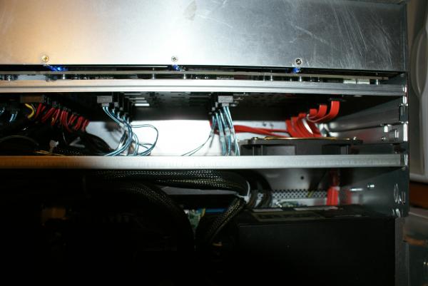

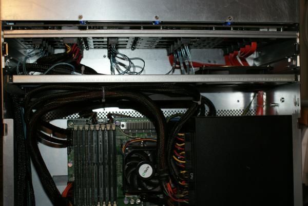

With the inspiration of and from Mikejp...
I finally got my ebay server to the volume and layout I was hoping for.
This was all made possible by ordering the Fan Wall and Back Window from Norco Direct.
With these parts and a new PSU and Case Fans... I was able to completely gut the older server case... eliminating the extremely noisy PSUs, 60mm fans, and side fans. I also had to remove the motherboard from its mounting tray, take out all the wiring for the redundant PSUs and unscrew the original back window.
Brass standoffs where used to hold the motherboard in its new location...
The modifications took me about 90 minutes and about $130 in additional hardware.
I am quite pleased with how it turned out.
Let me know if you have any questions...
John
Here are some pics:
Before:
After:
