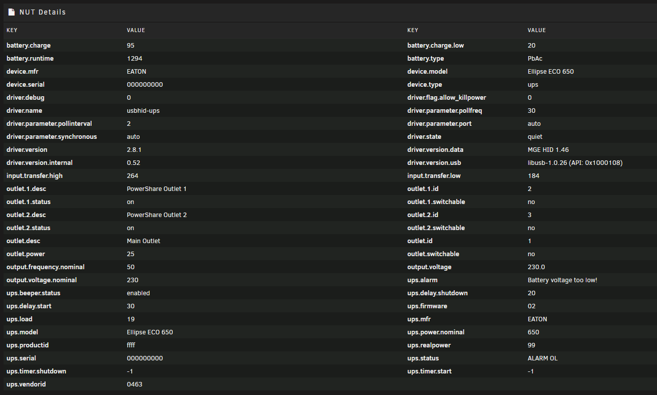

During a power outage today, my tower did an unclean shutdown despite running behind an Eaton Ellipse ECO 650.
After booting back up (outage was less than 2 minutes), the battery was barely discharged and the NUT plugin is saying that the UPS's battery voltage is too low, but the UPS is not beeping though.
Shutdown Mode is set to Time on Battery, with 10 minutes left before triggering a clean shutdown. I was logged on in ssh when the outage occurred and got the shutdown alert message almost instantly when the power was gone.
Is this a sign that the battery is dying? It is a bit old at this point (bought in January 2021, running 24/7 since then).
Likely that and battery have 3yrs+ age.
You can further apply some load to outlet and test does UPS would provide power for expected time duration.
Yeah, this is what I suspected after reading on other forums about the average 3 years lifespan of UPS batteries. I thought it was more like 5 years... Anyway, I ordered a new battery and will report back to confirm if that fixes my issue. Thanks!
I agree that this looks like the battery is degraded, the Eaton alarms are usually accurate.
I just installed the replacement battery and the alert went away at reboot. Thanks for your help!
