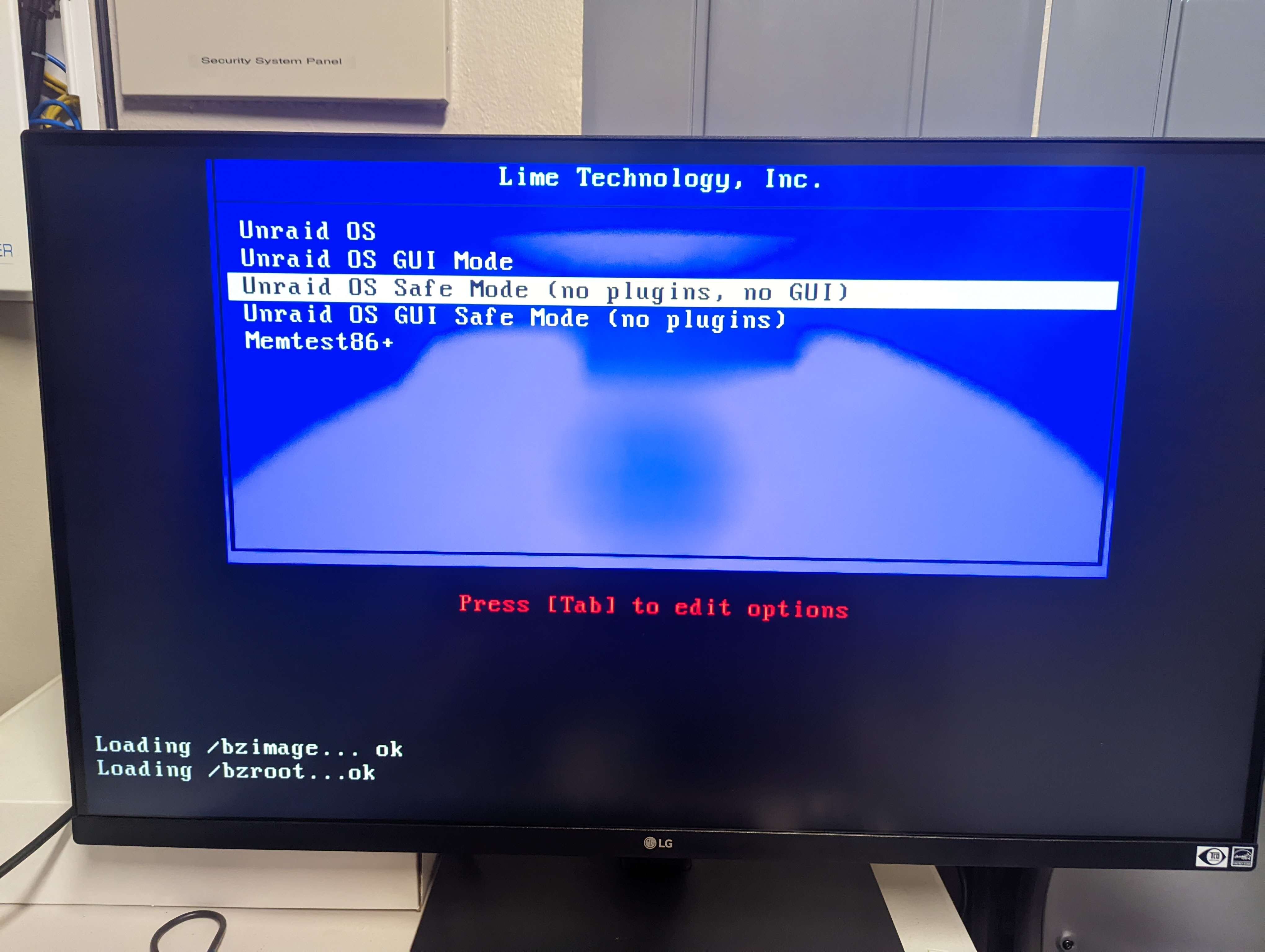

GUI Mode and GUI Safe Mode both result in the same behaviour as above, while non-GUI Safe Mode gets through 'Loading /bzimage... ok' and 'Loading /bzroot... ok' before getting stuck and idling there until I forcibly power the server down.

I encountered freezing and rebooting issues when attempting to boot Unraid 7.0.0 RC2 on my system. Based on the errors during boot, I modified my syslinux.cfg file to include specific kernel parameters, which resolved the issue.
default menu.c32
menu title Lime Technology, Inc.
prompt 0
timeout 50
label Unraid OS
  menu default
  kernel /bzimage
  append initrd=/bzroot intremap=no_x2apic_optout mce=off clocksource=hpet
label Unraid OS GUI Mode
  kernel /bzimage
  append initrd=/bzroot,/bzroot-gui intremap=no_x2apic_optout mce=off clocksource=hpet
label Unraid OS Safe Mode (no plugins, no GUI)
  kernel /bzimage
  append initrd=/bzroot unraidsafemode intremap=no_x2apic_optout mce=off clocksource=hpet
label Unraid OS GUI Safe Mode (no plugins)
  kernel /bzimage
  append initrd=/bzroot,/bzroot-gui unraidsafemode intremap=no_x2apic_optout mce=off clocksource=hpet
