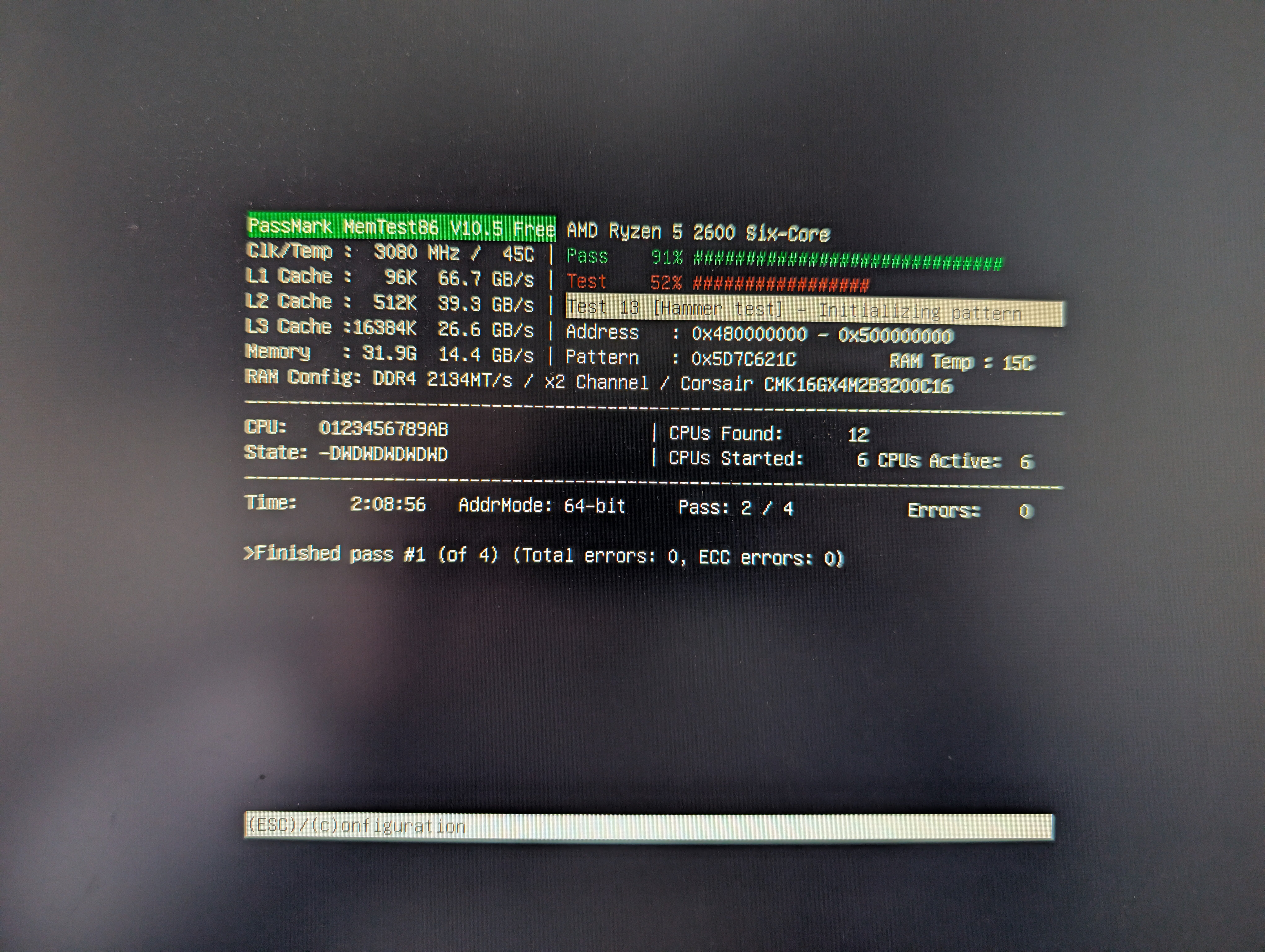

I've started to see slowly growing numbers of parity errors over the last week or so. I tried running 1 fixing partiy check but the errors have stayed. I think I saw some errors on disk 1 but they haven't reappeared since a reboot so I'm not totally sure where I should be looking to find the issue so any help would be greatly appreciated!

Start by running memtest.
How many passes should I do? I've done 1 so far without issuesPXL_20241019_121141069.thumb.jpg.a50db595a6c7cdaf2f08b8d47311fc66.jpg
Recommended is to let it run for 24-48h.
Also note that memtest is only definitive if it finds errors, if nothing is found and you have multiple sticks, try using the server with just one, then run a correcting check followed by a non correcting one, if there are still errors on the 2nd check, try with a different stick, that will basically rule out bad RAM.
