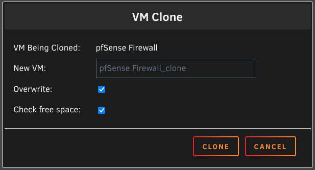

Clone VM, including vdisk, to new name - without modifying original
Is it possible to clone a VM including its vdisk, resulting in 2 distinct, independent, but otherwise identical copies of the VM?
Maybe I'm misunderstanding the UI, so any additional info would be greatly appreciated. This is what I'm seeing/doing...

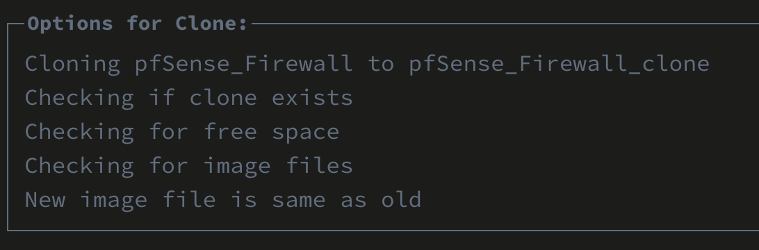

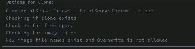

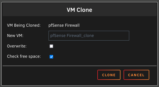

With the VM stopped, I select the clone option and then a window pops up asking for name and a couple of options:
I don't know if the "overwrite" option means to overwrite the original (doesn't make sense) or whether to overwrite any other clone with the same name I'm providing here (what I expect)
Either way, I deselect the overwrite option and then press the clone button - I have no clones at this point on the system. The result I get is the following error:
New image file name exists. What image filename? At this point I don't know what's going on, because I don't have any clones, nothing with the clone name I just specified. It would be easier to understand if the filename it thinks already exists was displayed in the error.
Can anyone shed some light here?
New image file name exists. What image filename? At this point I don't know what's going on, because I don't have any clones, nothing with the clone name I just specified. It would be easier to understand it the filename it thinks already exists was displayed in the error.
Which version are you running? Overwrite will overwrite and image file in the destination location if it exists.
At the moment, 7.0.0beta2 as I just rolled back to it from beta3 to test something else.
I'm waiting on a reboot to get back to beta3 but can't do that right now as I need to wait for the wife who's on a video meeting. This system is dedicated as my edge router :)
Destination being the new name I enter in the clone window right?  So there is no existing clone with that name and I'd expect not to get that error.
My VM storage path is a ZFS dataset.  /mnt/nvme_pool/vm_hosts/XXXXX/ - where XXXXX is the folder for each VM.

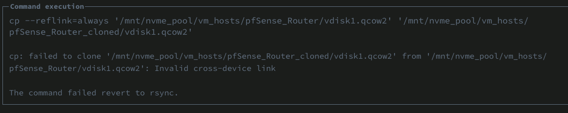

After starting the clone process above, I end up with a new dataset (XXXX-newname) for each clone I attempt to create. Each path is empty after the error.
Does the XML have volumes in a different path? can you post XML? Beta4 is due soon
Here's the XML for the VM

Here's a thought...  Is the check for an existing destination path (existing clone) happening AFTER the path is created? (on beta 2?)
I used another VM on a different system running beta 3 and both check-marks defaulted to un-checked (unlike beta2) and the clone process worked, unlike beta2 on the first system.
I've rebooted the first system to beta3, but I can't take down the VM right now to try cloning it again.
Beta3 still doesn't remove the VM's dataset when removing the VM and disks from the VM panel.
Edited by Espressomatic

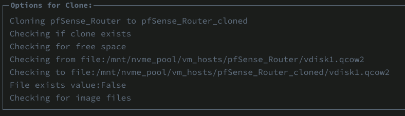

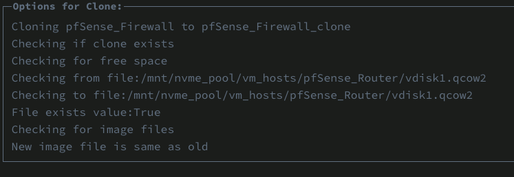

Well, nevermind about the above.  On my edge router system I still can't clone the pfSense VM, regardless of the check-marks. Something's odd.
Take a look a this error - it thinks the source and destination names are the same, no matter what I use for a destination name. This is with the Overwrite check-box checked.

I have added so addition entries into the log please can you put this file in /usr/local/emhttp/plugins/dynamix.vm.manager/include and try again.
Also can you provide
cat /boot/config/domain.cfg

Here's domain.cfg

and diagnostics after installing the new php file, rebooting, and trying the clone operation

Rebooting will revert, log is in the screen display not syslog.
Gotcha.
OK, looks like it's checking the source twice:
Also odd, sometimes the clone window appears with both boxes checked, sometimes empty. Also, clicking in the filename field automatically selects all the text and it's impossible to deselect it with any mouse clicks - need to use the cursor keys.

Gotcha.
I need to work out why it is not replacing the name
		if ($config['disk'][0]['new'] != "") {
		foreach ($config["disk"] as $diskid => $disk) {
			$file_clone[$diskid]["source"] = $config["disk"][$diskid]["new"] ;
			$config["disk"][$diskid]["new"] = str_replace($vm,$clone,$config["disk"][$diskid]["new"]) ;
			$pi = pathinfo($config["disk"][$diskid]["new"]) ;
			$isdir = is_dir($pi['dirname']) ;
			if (is_file($config["disk"][$diskid]["new"])) $file_exists = true ;
			write("addLog\0".htmlspecialchars("Checking from file:".$file_clone[$diskid]["source"]));
			write("addLog\0".htmlspecialchars("Checking to file:".$config["disk"][$diskid]["new"]));
			write("addLog\0".htmlspecialchars("File exists value:". ($file_exists ? "True" : "False")));
			$file_clone[$diskid]["target"] = $config["disk"][$diskid]["new"] ;
9 minutes ago, Espressomatic said:
Gotcha.
Ah your path and VM name do not match.
I have fixed the check boxes for next release.
You got it. After renaming the VM:
Is it normal for a VM on zfs to fail cp and need rsync?
I don't believe zfs supports copy on write unlike btrfs hences fails back to rsync.
