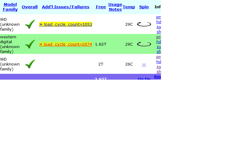

in mymain under add issues/failures it says load count  (see pic below ) What does this mean and how do you fix it .Is it anything to worry about . I tryed to click it to override it but nothing happens it just goes back to the way it was before. Any idea on this ? Thanks Ryan..

I tried asking a similar question - it appears that we don't need to worry, but if you do worry you can use a tool to change the time between "head parking" which would slow the rate of increase in that value.
Yes, that is the LCC (load cycle count) that plagues certain WD drives.  If it continues to increase at a rapid rate, it could be a problem.  This thread discusses it in detail.

mmmm okay so really nothing to worry about unless you see red..
Well do you think i should run the WDIDLE3 utility or just dont worry about LCC until i hit really high numbers?
No need to make any changes yet.  Keep an eye on your LCCs over the next few months, then make your decision based on that.
