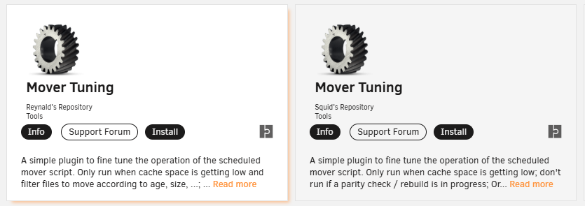

Has been running fine so haven't really needed to touch anything in mover tuner plugin. Fwitw this is the version of plugin I have installed
Hope some of this info is of help @vhw
