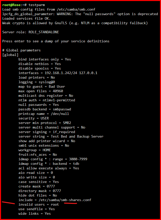

One very important thing:  Unraid does not allow  'root' SMB access.  You can see this as shown below:

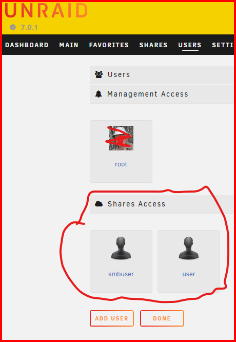

That refers to setting up  'Shares Access' users here:
Of course, these are the user names and passwords that you then use in the Windows Credential Manager.
