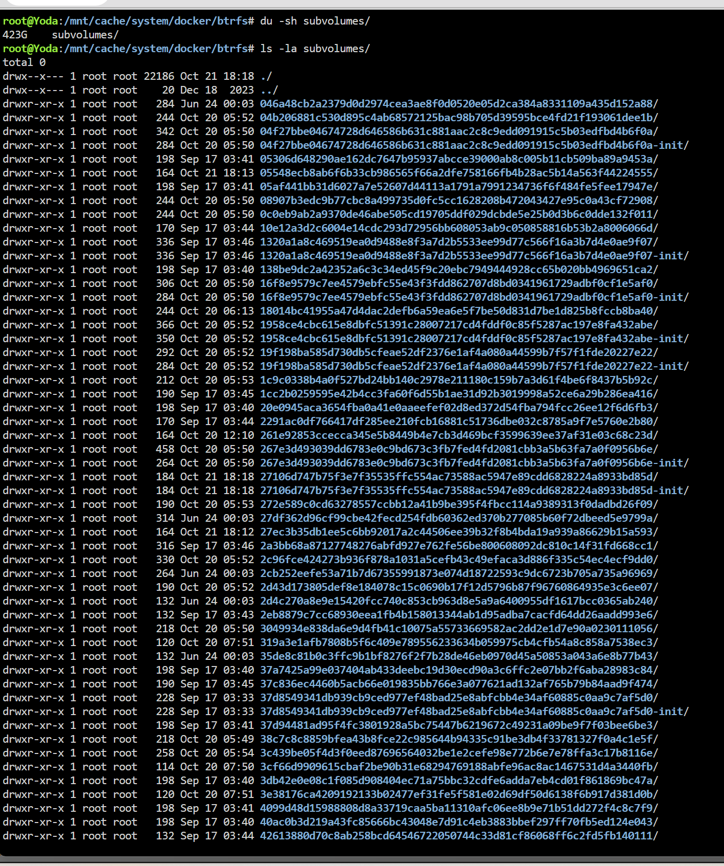

[Resolved, appreciate COD when avail.] Something's blown out my cache instantly?
I had just prior installed the Unifi-Controller Docker, hence the suspicion along with the folder name and contents - Each looks like a Docker
But i know not nearly enouh about Docker to be certain about it, hence the post here.
Help pls! I can't feel my legs! And the mrs just pgot home and slowly ill be notified by my Mrs Onsite location Notification integration one by one of all the things that arent working for her!!
EDIT: Issue has resolved itself.
- After self examination of the syslog (Logs att.), appears to have to trace bacl to within seconds of an unclean reboot = Poorly seated power cable, and i had to move it an inch.
- Whilst there's no urgency or major concern - It would be good to know how it happened from a learned from experience manner.
- Appreciate the time - I'm sure it will be a quick one!

Btrfs is detecting data corruption on both pools device, you should run a correcting scrub, also a good idea to run memtest.
No need to look further, unexpected power loss is always likely to cause corruption.
