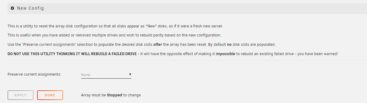

I would direct more towards the Unraid webUI tools new config:
as if you made a unraid flash drive backup the data on disk assignment is saved in the config folder and data is not lost. Since your doing an overhaul to the disk arrangement it will be hard to maintain the disk data. A more experienced Unraid /Forum user may be better able to assist you here.
do you have a unraid backup what so ever to copy the config folder over?
if not unraid should see the fomated disk but you will need to mimick the same disk aray and setup. If ZFS you will need to install the zfs mater plugin and import. If disk array assign teh disk arcoding to your previous disk 1 and parity. Unassgned disk can be used to help mitgate and move between restup of the array.
