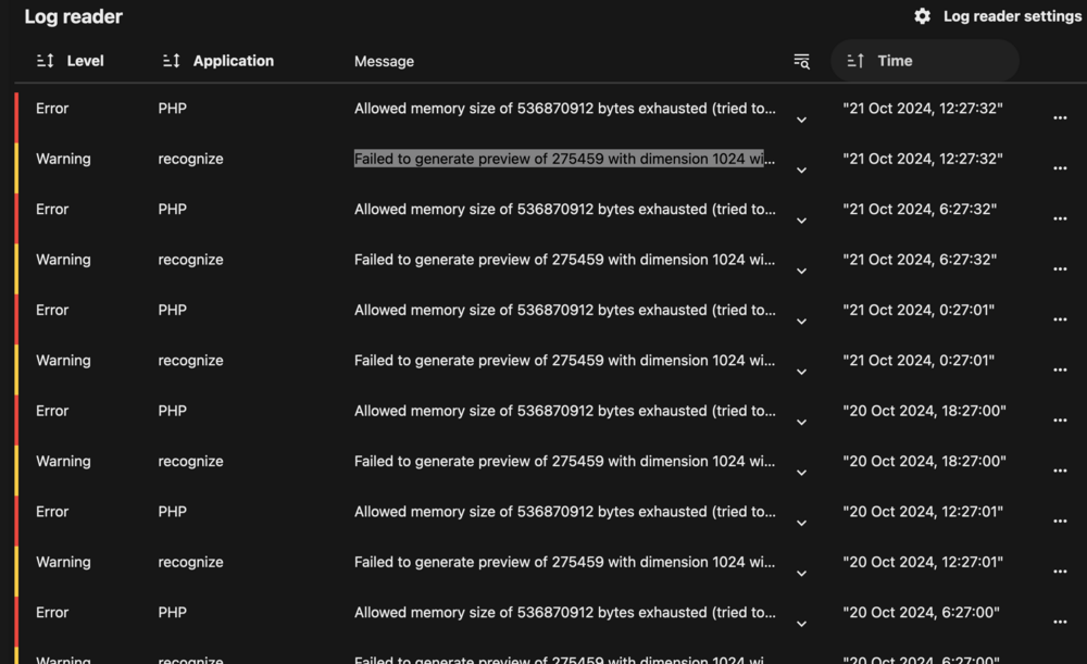

Hello friends,
I am running Nextcloud AIO 29 on Unraid.
I'm seeing two types of repeating error messages in the log:
1. for PHP application: "Allowed memory size of 536870912 bytes exhausted (tried to allocate 40960 bytes) at /var/www/html/custom_apps/recognize/lib/Classifiers/Classifier.php#360"
2. for recognize application: "Failed to generate preview of 275459 with dimension 1024 with nextcloud preview manager: No provider successfully handled the preview generation"
After googling these errors, I understand I should try to increase Nexcloud AIO's PHP memory limit from 512MB to 1GB.
Can anyone please explain how I should do this?
Thank you 🙏

I tried to add the line:
--env NEXTCLOUD_MEMORY_LIMIT=1GB
in the Extra Parameters section of the nextcloud-aio-mastercontainer docker container setup page, but once I saved this change the container wouldn't start, so I had to remove this line.
Should I maybe add this line as a Variable instead?
What should I write for the Key?
And what should I write for the Value?

You did a little mistake which is mentioned on the page.
It must start with a number and end with M e.g. 1024M
So =1GB is wrong. =1024M should do the trick^^

Many thanks 🙏 🙏
It worked :)

I think the difference is that you provided GB instead G
