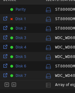

@JorgeB, thank you for the advice with the GPU.  After removing the GPU, the system seemed to be a bit more stable, but then I just had a drive become disabled.  But at least Im able to pull diagnostics this time.  It did seem like it locked up hard, but came back and then the disk was not there.  The disks are all connected via an HBA.

Thanks @JorgeB.  I moved the HBA, but Im still seeing a disabled drive.
Is my HBA borked?  Should I try that drive with a sata cable?

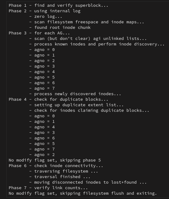

ETA, I ran the filesystem check with the -n flag and got the following:
tower-diagnostics-20241024-1930.zip
