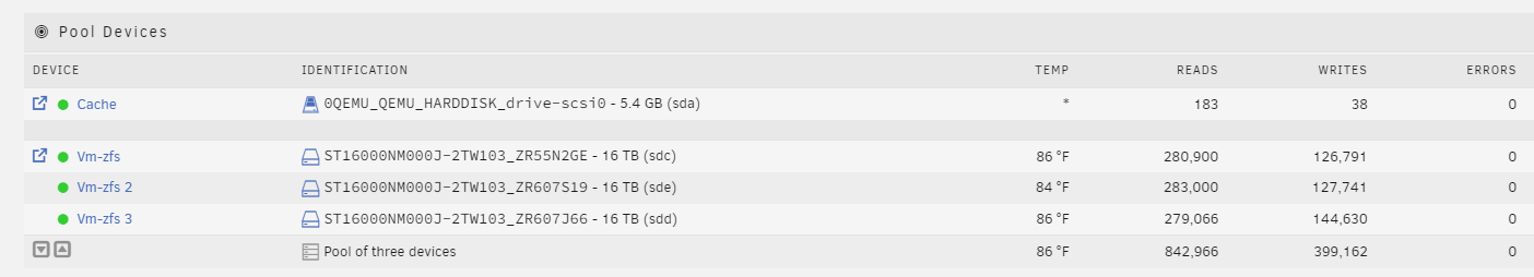

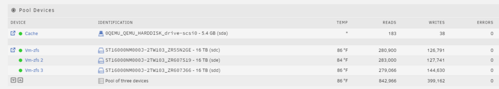

So setup your NVME as a
3x m.2 as a zfs raidz1 for speed and space
2x 2TB as a ZFS Mirror
1x 4tb as cache

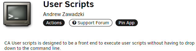

You can then use plugins such as user script and appdata backup to copy and move items off for backups auto-magicaly. and if a disk in the zfs array die, the data isn't lost and easily recoverable with a replacement add to the missing disk in the pool device and resliver the new HD.
The NVME array should store and be used for your VMs and Docker Application Data
The 2xMirror disk can be you bigger media libaray data and used for NAS and Main shares.
The 1x4TB as the cache disk as ?btrfs? and be the main backup for the appdata folder (due to default docker templates) and data location for plugin or user script to copy/rsync and make a location for back data to as a active parity disk between both pools.

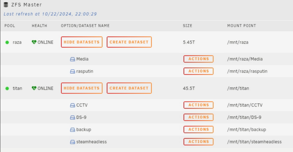

You just have to remember to go into the share folder after coming up with datasets in zfs on the main page.
So once all datasets are made.. In Shares be sure to set storage location before using them.

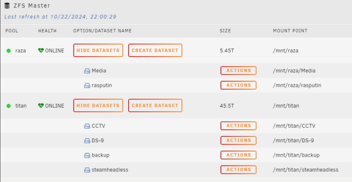

Hear are some other example that I run.:
Go to shares, click the dataset name and under
Chose your Primary Storage pool.

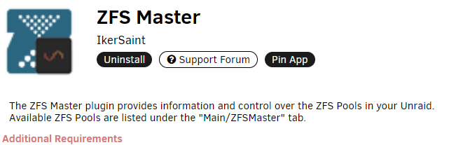

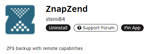

ZFS plugins.
Snapshots to see zfs snapshots and btrfs snapshots...

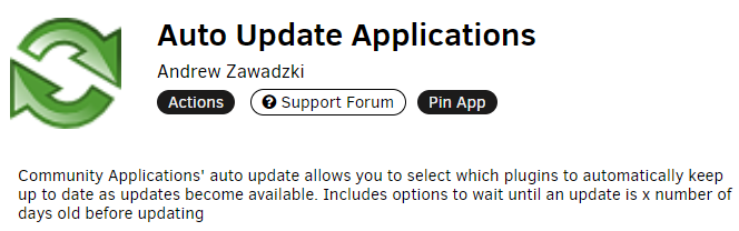

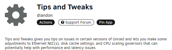

General unraid Must Haves

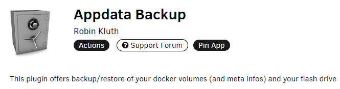

Backup Tools and Utilities:

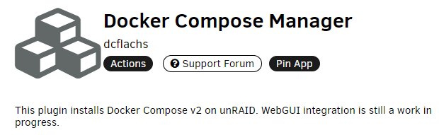

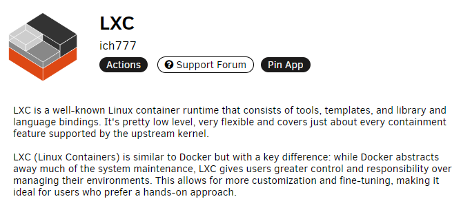

Additional Add-on Systems (Docker compose and LXC):

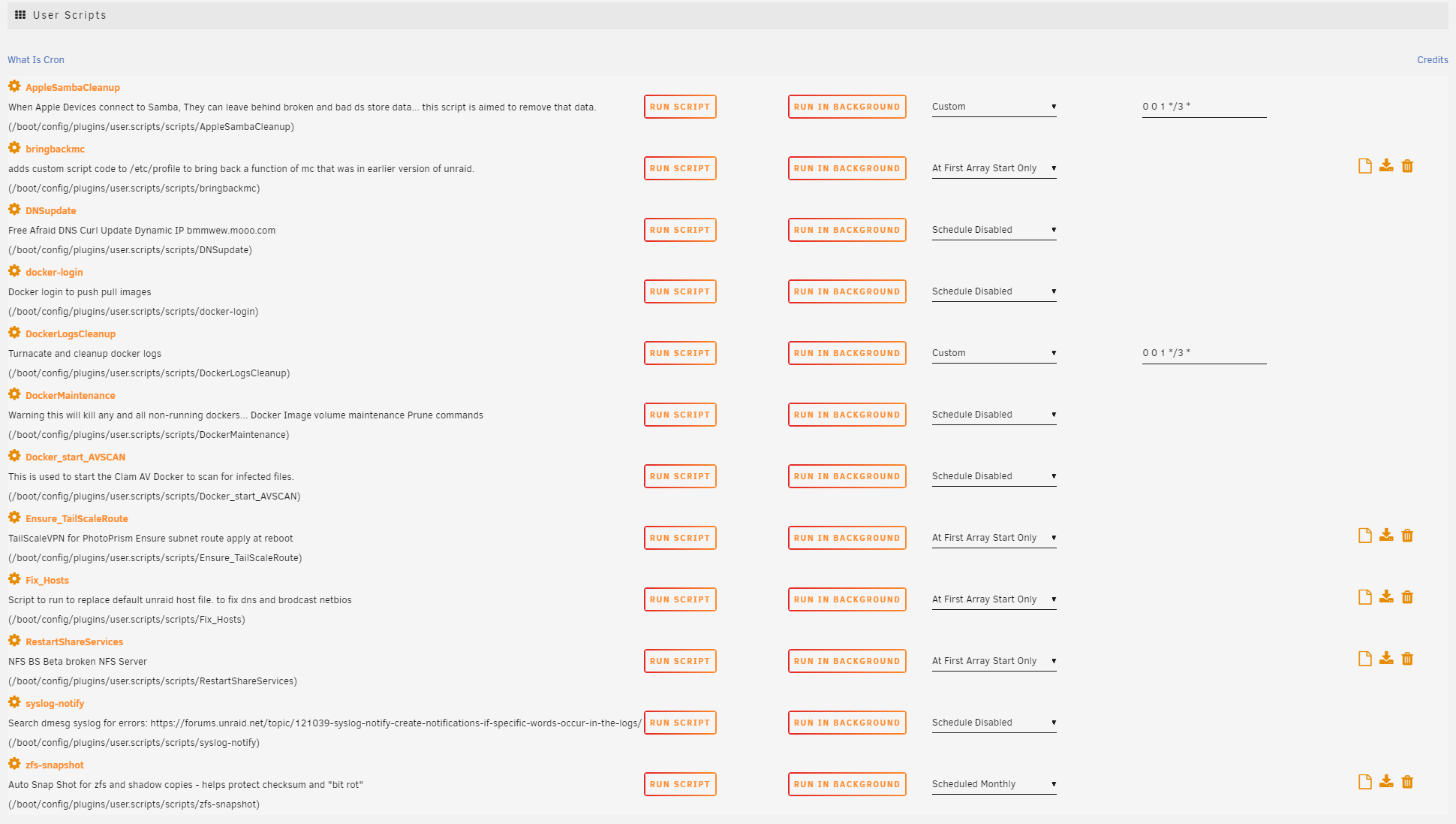

I also recommend running some user script at first array startup:
The Main scirp to run is more for ZFS and creating snapshots for shadow copy backups within ZFS.

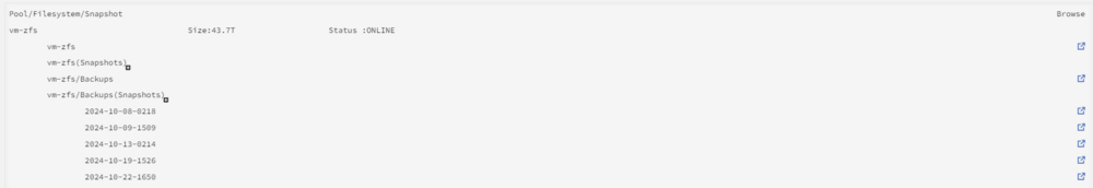

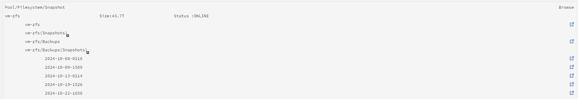

Using snapshot plugin, one can investigate and inspect.
