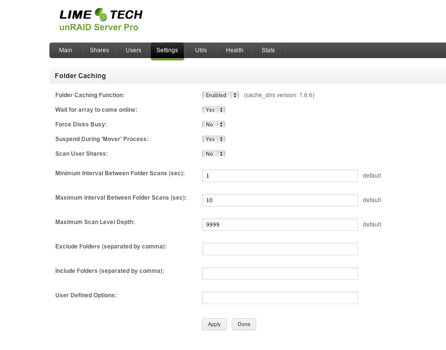

Just noticed that the folder caching menu in settings (running SimpleFeatures GUI) has the 'suspend during mover process' enabled so I assume it is being disabled before the mover runs, i.e. same outcome as your script?
I've ordered more memory but I assume it just uses an available amount for caching so I won't see any benefit - or is it a set maximum value is utilises limited by the levels / files it caches?
My apps are all running out of user/local - isn't that in RAM? Might be worth running out of a temp file on the cache drive I guess and setting up a swap-file. I'll see if that helps. If it doesn't I'll disable cache dirs to test.

No, sorry, I had thought that the GUI disable cache-dirs before mover would accomplish that.
Best to be sure! Will add it now and try (assuming the  mover script is easy to find!).
