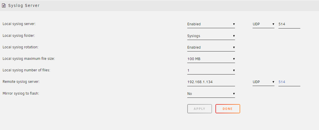

The regualr syslog starts over after every boot, post a screenshot of the syslog server settings.
Hey JorgeB, my syslog does include information from days before the last system crash, but not from the day that the last crash occurred.
Here are my syslog settings.

The persistent syslog is the one that should have the more info, the syslog in the diags starts over after every boot, so it won't help after a crash.
