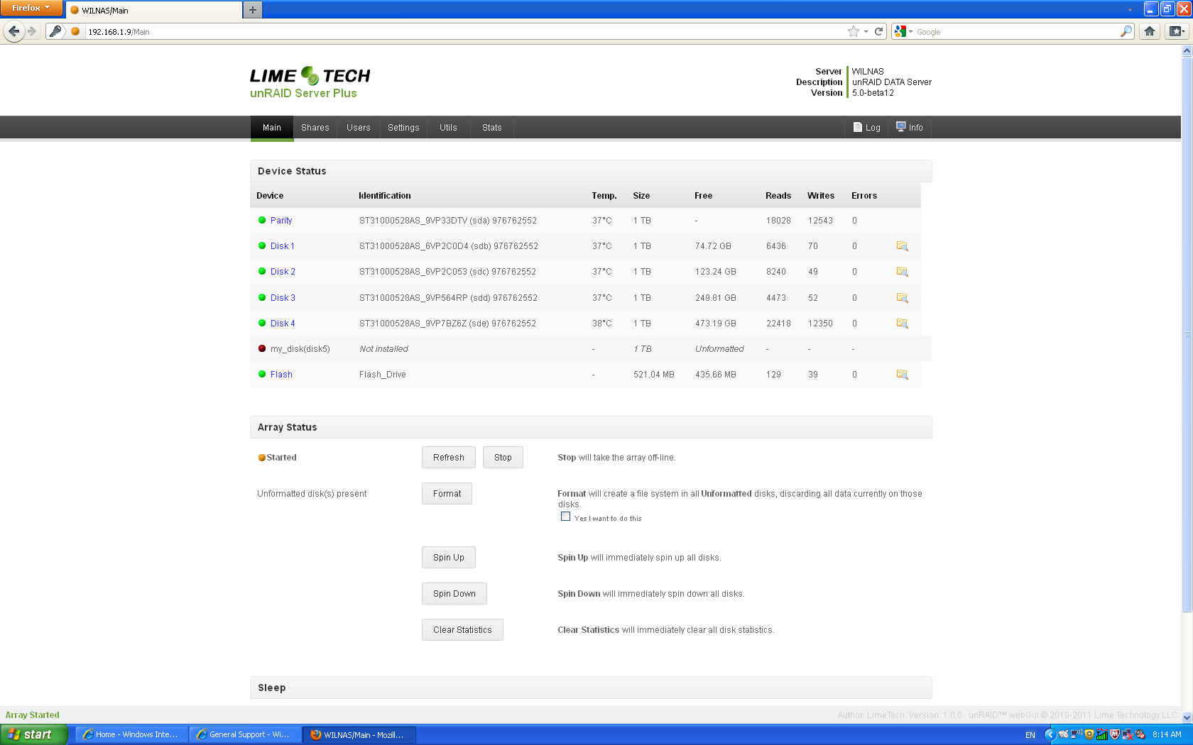

I am hoping that someone can help me. My setup is I have 5 1TB Drives and I decided that I wanted to add another 1TB drive to the array. I added the disk and then I decided I didn't want it so I removed it from the server.
Now when I start the array I get the disk showing as "Not Installed" on the main page. I want to remove this from the array as I have physically removed the disk from the server.
I have run the initconfig command to rebuild the array information but I am not seeing any change as yet.
I have attached a screenshot showing my Main Page.
Any help would be appreciated.

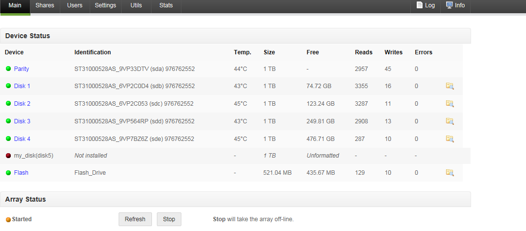

I stopped the Array and then via telnet completed the command "initconfig" and answered Yes. It did say Completed, though I am not seeing any change on the main page. The disk is still present and the Array status is still amber.
Any more help would be greatly appreciated.
Yep page was refreshed.
I have attached another screenshot of the main page.
As a side note with the drive that is now showing up as "Not Installed" I did not unassign this drive before removing it from the server. I simply unplugged it and took it out and then booted the server back up.
So basically my request is how to remove a drive that hasn't originally been unassigned.

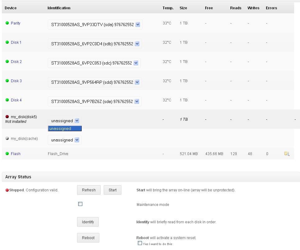

I have stopped the Array and have taken a screenshot of the options I have for Disk 5 (the one that was removed).
I also did an Identify and the below is from the syslog.
Feb 27 10:44:14 WILNAS kernel: mdcmd (3): import 2 8,32 976762552 ST31000528AS_6VP2C053
Feb 27 10:44:14 WILNAS kernel: md: import disk2: [8,32] (sdc) ST31000528AS_6VP2C053 size: 976762552
Feb 27 10:44:14 WILNAS kernel: mdcmd (4): import 3 8,48 976762552 ST31000528AS_9VP564RP
Feb 27 10:44:14 WILNAS kernel: md: import disk3: [8,48] (sdd) ST31000528AS_9VP564RP size: 976762552
Feb 27 10:44:14 WILNAS emhttp: shcmd (208): /usr/local/sbin/emhttp_event driver_loaded
Feb 27 10:44:14 WILNAS emhttp_event: driver_loaded
Feb 27 10:44:14 WILNAS kernel: mdcmd (5): import 4 8,64 976762552 ST31000528AS_9VP7BZ6Z
Feb 27 10:44:14 WILNAS kernel: md: import disk4: [8,64] (sde) ST31000528AS_9VP7BZ6Z size: 976762552
Feb 27 10:44:14 WILNAS kernel: mdcmd (6): import 5 0,0
Feb 27 10:44:14 WILNAS kernel: md: disk5 removed
