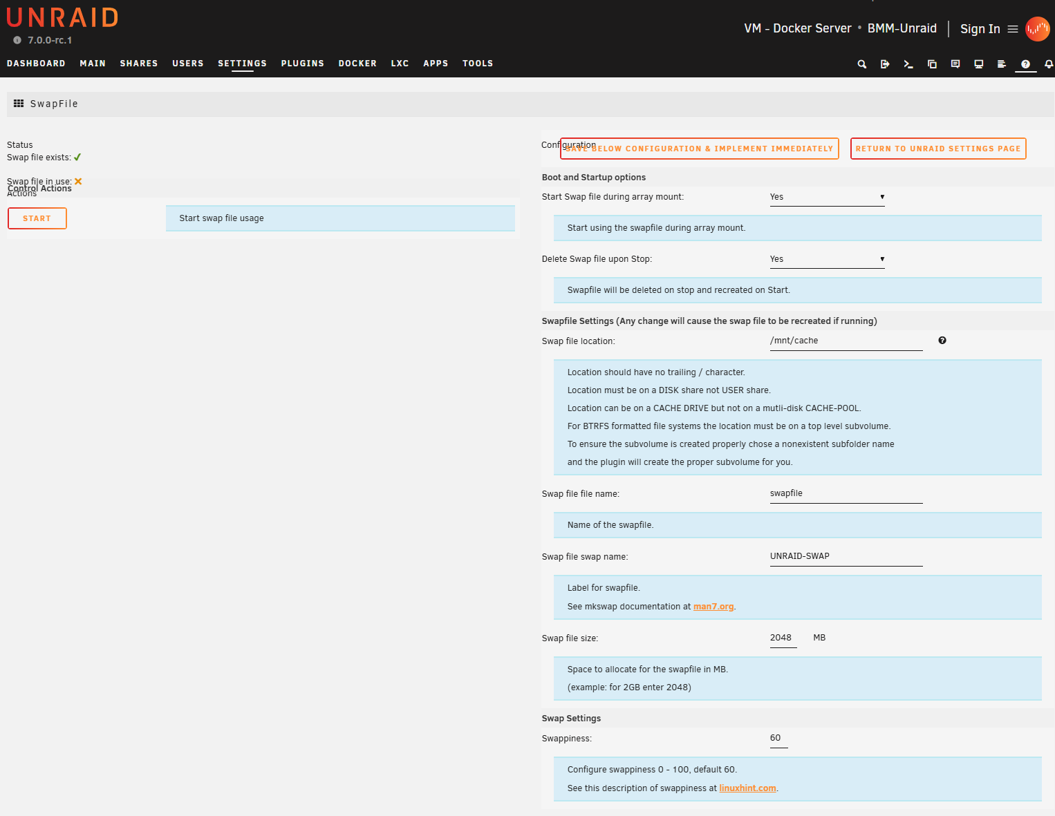

December 4, 20241 yr Author Unraid in a VM I want a swap file... plugin has issues and can break due to adding a swap file to a qemu vdisk...So lets rebuild and make a swap file... First stop the array!the array needs to be stoped!Then run theses commands!as we will be rebooing after making are wap file...identify your disk. since i'm using a usb registered as /dev/sda as my usb is vm passed for unraid...My vdisk shows up as /dev/sdb(Earlier we mountied and disk and formated it as btrfs 1 disk pool called cache)lsblkthese commands are saved for code prosperity.sdb 110G disk└─sdb1 100G partYou must mount /dev/sdb1, NOT /dev/sdbmkdir -p /mnt/cache mount -t btrfs /dev/sdb1 /mnt/cache mount | grep /mnt/cache as the arry is off this mounts our vm cace disk...Now to save and create the swap file..We Create the swap subvolume (REQUIRED on BTRFS) and disable Copy on Write!!!btrfs subvolume create /mnt/cache/swap btrfs subvolume list /mnt/cache lsattr /mnt/cache | grep swap *You must see a C.Create the 2 GB swapfile (SAFE METHOD)fallocate -l 2048M /mnt/cache/swap/swapfile mkswap /mnt/cache/swap/swapfile swapon /mnt/cache/swap/swapfile swapon --show free -h You should now see a 2 GB swap file...no plugin stillahve and use... add to go file:swapon /mnt/cache/swap/swapfileAs I get into werid areas where this should work and it doen'ts this is a work around to get it to work... as once again the plugin refused to make the corect btrfs sub coume nor make the swap file...########################################################################################################################################################################################################################################################################Old Orginal Data for post responses..:plugins a bit old... and needs some work...I use it on a btrfs sytem to fix some docker and swappiness issues... May need to reach out to primeeval_god on some updates and fixes... swap file broken, more then usual?Dec 3 17:37:08 BMM-Unraid rc.swapfile[14459]: Starting swap file during array mount ... Dec 3 17:37:08 BMM-Unraid rc.swapfile[14474]: Swap file /mnt/cache/swapfile is on a BTRFS file system but does not have the No_COW attribute.Lets fix it with this script:#!/bin/bash # Show current swap status swapon --show # Turn off all swap files swapoff -a # Remove existing swap file rm -f /mnt/cache/swapfile # Ensure No_COW is set on the cache directory chattr +C /mnt/cache/ # Create a new 2GB swap file dd if=/dev/zero of=/mnt/cache/swapfile bs=1M count=2048 # Set correct permissions chmod 600 /mnt/cache/swapfile # Format the swap file mkswap /mnt/cache/swapfile # Activate the swap file swapon /mnt/cache/swapfile # Show swap status to confirm it's active swapon --show So Lets fix swap:more on there support: Edited December 15, 2025Dec 15 by bmartino1 Data- Info - Scritp workaround fixes -- More for VM quirks

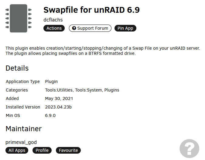

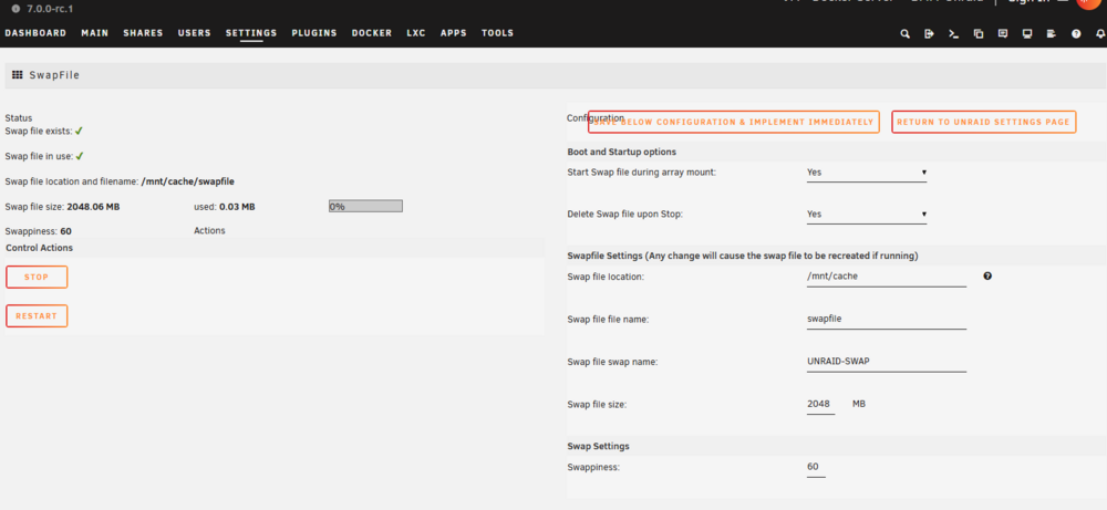

December 4, 20241 yr 2 hours ago, bmartino1 said: plugins a bit old... and needs some work... I use it on a btrfs sytem to fix some docker and swappiness issues... May need to reach out to primeeval_god on some updates and fixes... swap file broken, more then usual? Dec 3 17:37:08 BMM-Unraid rc.swapfile[14459]: Starting swap file during array mount ... Dec 3 17:37:08 BMM-Unraid rc.swapfile[14474]: Swap file /mnt/cache/swapfile is on a BTRFS file system but does not have the No_COW attribute. Lets fix it with this script: The script should not be necessary. The error message is because you specified "/mnt/cache" as the location for the swapfile on a BTRFS drive. As the help text for the swapfile location notes you need to choose a non-existing directory name. The plugin will then create a subvolume at that location with the proper options for the swapfile.

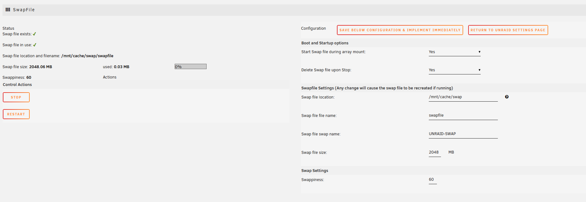

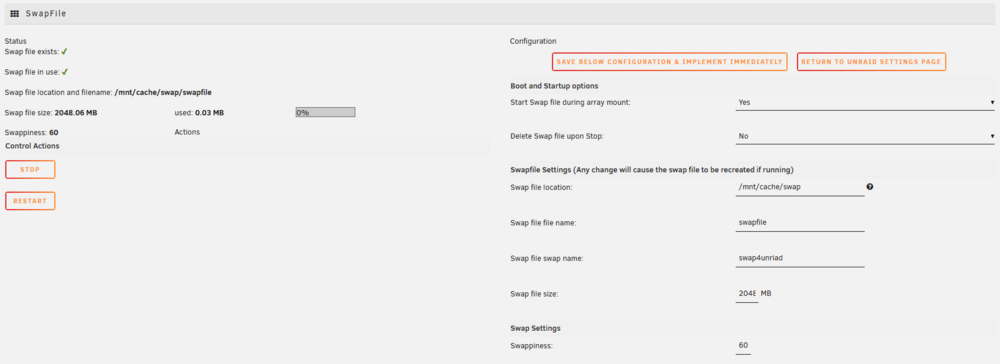

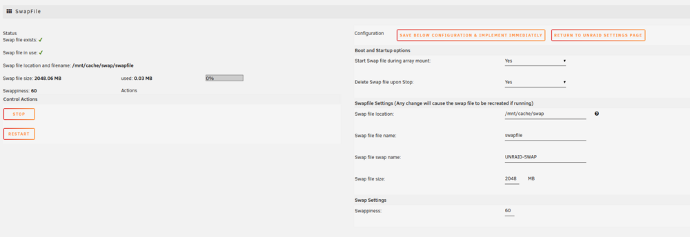

December 4, 20241 yr Author Just now, primeval_god said: The script should not be necessary. The error message is because you specified "/mnt/cache" as the location for the swapfile on a BTRFS drive. As the help text for the swapfile location notes you need to choose a non-existing directory name. The plugin will then create a subvolume at that location with the proper options for the swapfile. I even made a seperate share and set COW to no for a share called swap I haven't seen this work without that above script.
December 4, 20241 yr You must specify a folder that does not exist and let the plugin create the folder.
December 4, 20241 yr Author Just now, primeval_god said: You must specify a folder that does not exist and let the plugin create the folder. I'm telling you it would never make that folder... this was the workaround
December 4, 20241 yr Author For me its more errors with dockers that sometimes complain about swap and wanting a unraid host level swap file... Here is a revised script for zfs... which would shutup the docker error with a file created but not running... script is atm a backup for a different machine.. poolname enterprise dataset swapfile 2GB vdev while the swap plugin was meant for use on cache disk btrfs. I have found a way to make and use swap on a zfs only pool system... working with plugin the two main errors with trying to use zfs and swap are 1 zfs doesn't support the attribute +C (copy on right...) when directed at a folder within a dataset or on the dataset itself... Since it appears the plugin is strictly expecting a file-based swap and not a ZFS zvol. Since ZFS doesn't natively support traditional swap files, some adjustments need to be made either to the plugin or the configuration to make this work. *If fallocate is not available on your system (it might not be in Unraid's shell), use dd with conv=notrunc to ensure no sparse regions are created On a zfs only with plugin at command step: # Activate the swap file swapon /mnt/cache/swapfile/swapfile (cache the pool name and swapfile the dataset swapfile the vdev) So the plugin can crete a file no proble but cant activate due to error with COW (copy on write...) so at the swapfile in a dataset without the option copy on write in the directly off would have swapon error "it appears to have holes..." The error "it appears to have holes" suggests that the ZFS file system is still creating a sparse file despite attempts to disable Copy-On-Write otherwise known as (sync=disabled) also we could use fallocate. This happens because ZFS inherently handles files differently from other file systems like EXT4 or XFS.... ZFS zvol volumes are raw block devices, so they avoid all the pitfalls of file-based swap on ZFS datasets. This eliminates issues related to Copy-On-Write, sparse files, and the holes error... So remove the swap plugin. and use this startup script. #!/bin/bash # Show current swap status swapon --show # Turn off all swap files swapoff -a # Destroy existing ZFS swapfile dataset if it exists echo "Destroying existing ZFS swapfile dataset (if it exists)..." zfs destroy -r -f enterprise/swapfile # Create a new ZFS dataset with disabled sync for the swapfile echo "Creating new ZFS dataset for swapfile..." zfs create -o sync=disabled enterprise/swapfile # Verify ZFS dataset properties echo "Checking ZFS dataset properties..." zfs get sync,compression enterprise/swapfile # Create a ZFS zvol for swap echo "Creating a 2G ZFS zvol for swap..." zfs create -V 2G enterprise/swapfile/swapfile # Format the zvol as swap space echo "Formatting the zvol as swap..." mkswap /dev/zvol/enterprise/swapfile/swapfile # Enable the swap echo "Activating the swap..." swapon /dev/zvol/enterprise/swapfile/swapfile # Verify the swap is active echo "Verifying the swap..." swapon --show #set swappiness defualt 60 atleast 10 rec servers echo "vm.swappiness=10" >> /etc/sysctl.conf sysctl vm.swappiness=10 Using swap on ZFS (or any disk-backed storage) can be a double-edged sword, especially on ZFS, due to its unique Copy-On-Write (CoW) nature. Below are some considerations for why you might want (or not want) swap on ZFS-based disks, and alternative approaches to handle swap efficiently in Unraid. Reasons to Use Swap on ZFS: Handling Memory Overcommitment: If your system is running out of RAM (especially with Docker containers and VMs), swap provides a fallback mechanism to prevent processes from crashing. Avoiding Out-of-Memory (OOM) Errors: Unraid might kill processes if the system runs out of memory. Having swap prevents abrupt service interruptions due to OOM kills. Temporary Relief for High Memory Loads: Swap provides temporary relief during memory spikes, especially for infrequently accessed data, even if it incurs performance penalties. No Other Disks Available: If all your disks are ZFS-based and you have no other storage options (like SSDs or non-ZFS devices), a ZFS-backed swap may be your only choice. Reasons to Avoid Swap on ZFS: Performance Penalty: ZFS is designed for data integrity and CoW, which can conflict with the typical access patterns of swap. Even when using sync=disabled, ZFS overhead may lead to slower swap performance compared to raw disk or dedicated swap partitions. High Disk Activity: Swap generates frequent small writes, which can lead to excessive disk activity on ZFS pools, reducing their performance and potentially increasing wear on SSDs or HDDs. Risk of Deadlock: ZFS itself consumes memory for managing its datasets (ARC, metadata, etc.). If the system starts swapping ZFS metadata or ARC data, it can lead to a feedback loop where ZFS struggles to free up memory, potentially causing system instability. Better Alternatives Exist: Swap is typically a last resort for extending memory. Using RAM optimally (e.g., limiting VM or Docker resource usage) or adding more physical memory is preferable. some other side fixes on zfs with swap: Optimize ZFS Memory Usage Reduce ZFS ARC (Adaptive Replacement Cache) size to free up more RAM for other processes: echo "arc_max=4G" >> /etc/modprobe.d/zfs.conf Use a Compressed RAM Disk (zram) for Swap Instead of relying on disk-based swap, you can configure a compressed RAM disk for swap (via zram). This is faster and avoids disk I/O entirely modprobe zram echo lz4 > /sys/block/zram0/comp_algorithm echo $((2*1024*1024*1024)) > /sys/block/zram0/disksize # Set to 2GB mkswap /dev/zram0 swapon /dev/zram0 *would pull ram and make a ram disk in memory / disk cache... Edited December 4, 20241 yr by bmartino1
