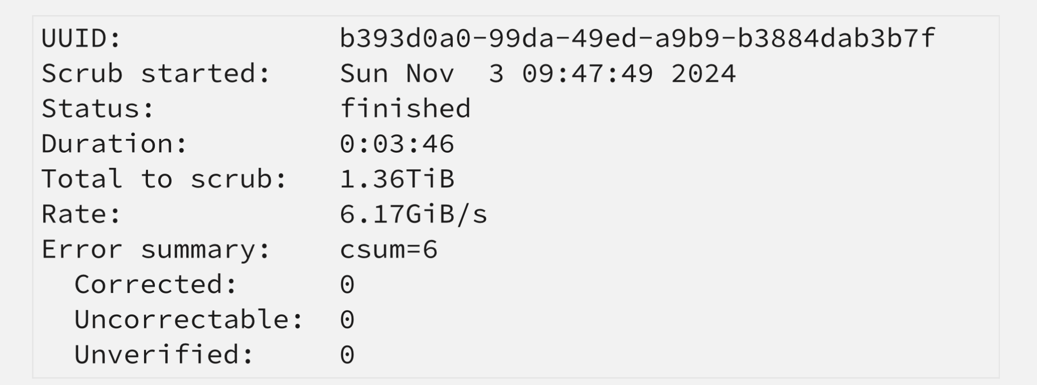

I ran a scrub on the NVME01 Device, This is the disk log from the start to the end of the scrub.
Nov  2 12:02:36 Tower kernel: BTRFS info (device nvme0n1p1): scrub: started on devid 1
Nov  2 12:02:39 Tower kernel: BTRFS warning (device nvme0n1p1): checksum error at logical 14426165248 on dev /dev/nvme0n1p1, physical 15508295680, root 5, inode 258, offset 13200904192, length 4096, links 1 (path: PlexVM-WIN10Updated.img)
Nov  2 12:02:39 Tower kernel: BTRFS error (device nvme0n1p1): bdev /dev/nvme0n1p1 errs: wr 0, rd 0, flush 0, corrupt 122, gen 0
Nov  2 12:02:39 Tower kernel: BTRFS error (device nvme0n1p1): unable to fixup (regular) error at logical 14426165248 on dev /dev/nvme0n1p1

Nov  2 12:06:17 Tower kernel: BTRFS info (device nvme0n1p1): scrub: finished on devid 1 with status: 0

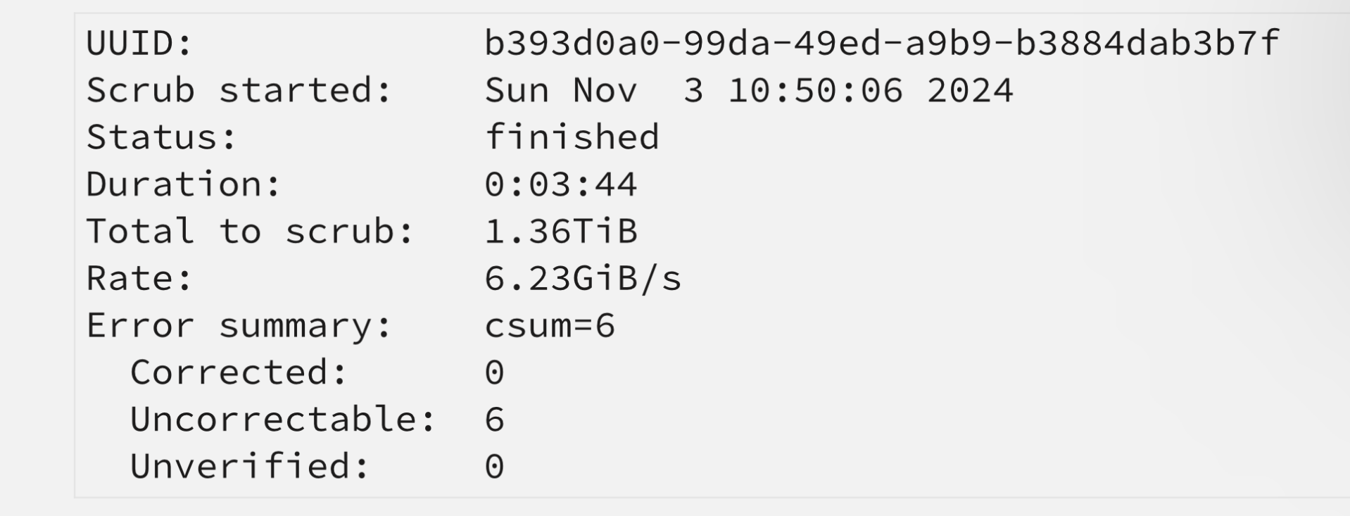

Is there Somewhere to pull just the Scrub Log from?
I meant the GUI results from the scrub, but I assume there were uncorrectable errors? If yes, delete/restore the file listed in the syslog and re-run to confirm no more errors
sorry, here is the GUI result after running another scrub

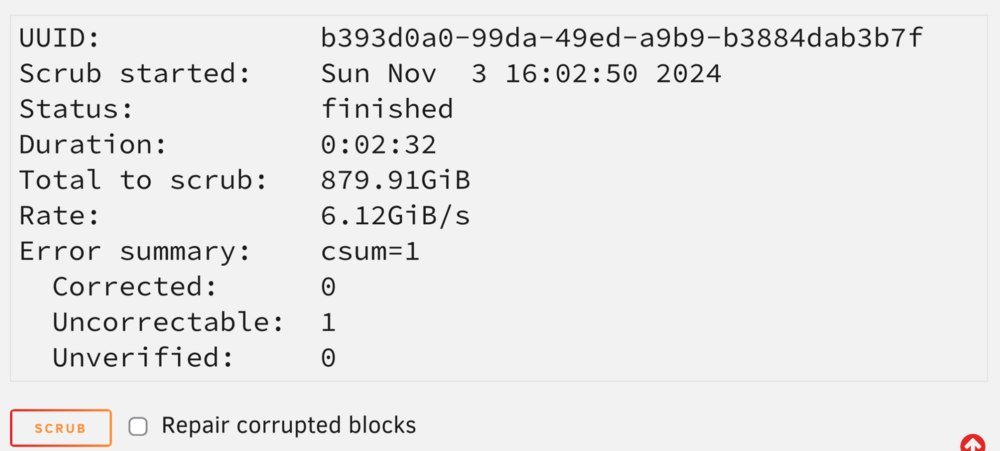

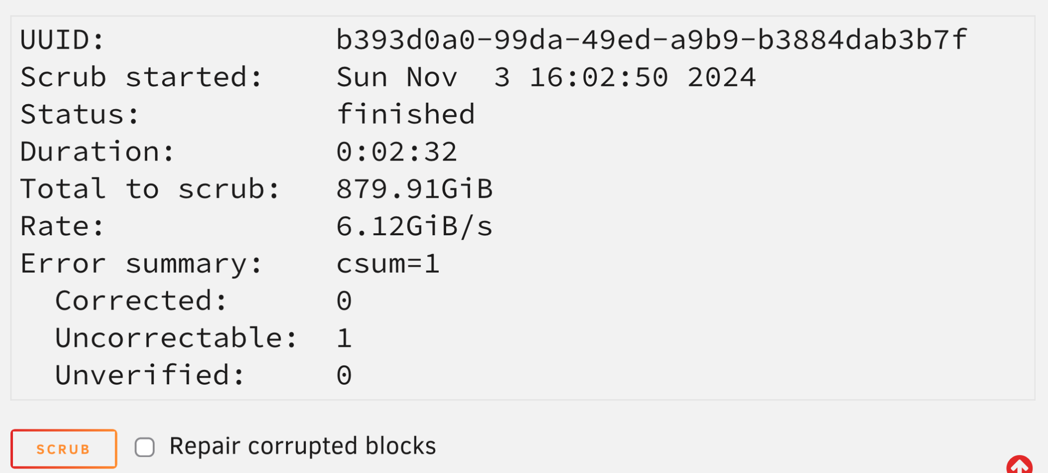

Removed the VM image and ran another correcting scrub here’s the syslog result
Nov 3 16:02:50 Tower ool www[22751]: /usr/local/emhttp/plugins/dynamix/scripts/btrfs_scrub 'start' '/mnt/vm_nvme_new' '' Nov 3 16:02:50 Tower kernel: BTRFS info (device nvme0n1p1): scrub: started on devid 1 Nov 3 16:02:53 Tower kernel: BTRFS warning (device nvme0n1p1): checksum error at logical 14426165248 on dev /dev/nvme0n1p1, physical 15508295680, root 5, inode 258, offset 13200904192: path resolving failed with ret=1 Nov 3 16:02:53 Tower kernel: BTRFS error (device nvme0n1p1): bdev /dev/nvme0n1p1 errs: wr 0, rd 0, flush 0, corrupt 189, gen 0 Nov 3 16:02:53 Tower kernel: BTRFS error (device nvme0n1p1): unable to fixup (regular) error at logical 14426165248 on dev /dev/nvme0n1p1 Nov 3 16:05:22 Tower kernel: BTRFS info (device nvme0n1p1): scrub: finished on devid 1 with status: 0
Scrub result:
the disk I copied the Img onto it isn’t reporting any errors with the file
