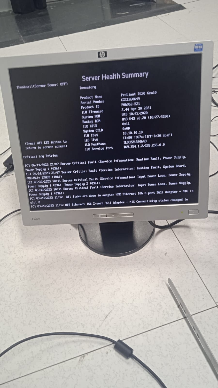

After a power cut, the DL20 G8 server displays a ScreenShoot on startup,
is it a battery problem or something else
Thanks for your Support
is it a battery problem or something else , Thanks for your Support
Hi, i already change the batteries,
the same issue
Error "Server Critical Fault (Service Information: Runtime Fault, Power Supply, Power Supply 1 (01h))
Error "Server Critical Fault (Service Information: Runtime Fault, System Board, P12V Main/AUX Regulators (04h))
