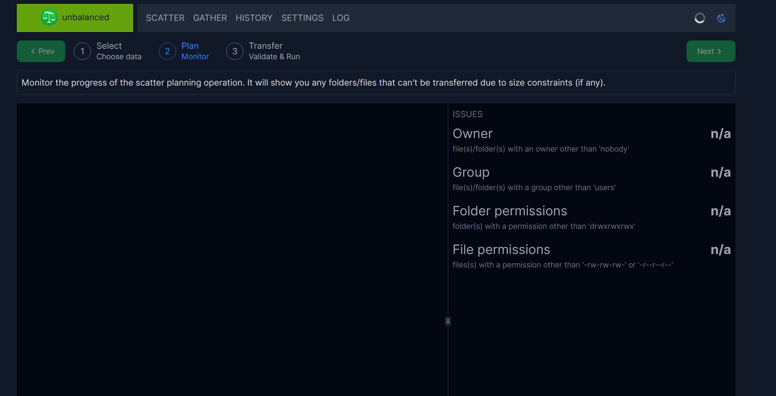

@JorgeB do you can tell me a good solution to move all items from disk1 to disk2 and disk3? I am trying to do this with the plugin "unabalanced", but when i select all the items from disk1 the calculation at step2 takes too long.
I would recommend upgrading to v7-rc.2, you can then use the new mover function to empty an array disk.
v7 cannot have a pool with unassigned devices, just remove the pool for now, you can add it back later.
