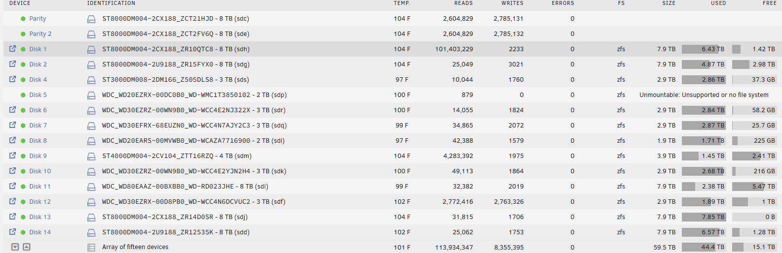

I did a reboot of my server - and when it came back up I noticed that disk 5 is MIA.
UNRAID shows the drive. And reports Unmountable Unsupported or no file system. image.thumb.png.6e49cc47c6fa8fe780e596bec24a7daf.png
