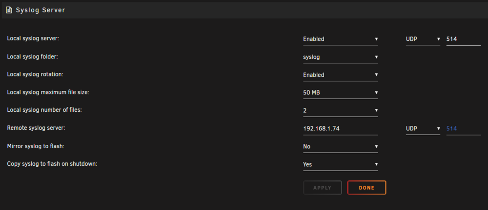

I just updated them as I was doing some searching and looks like I might have had the setting improperly setup.
I did not have local syslog rotation enabled
I did not have remote syslog server IP setup as my server IP

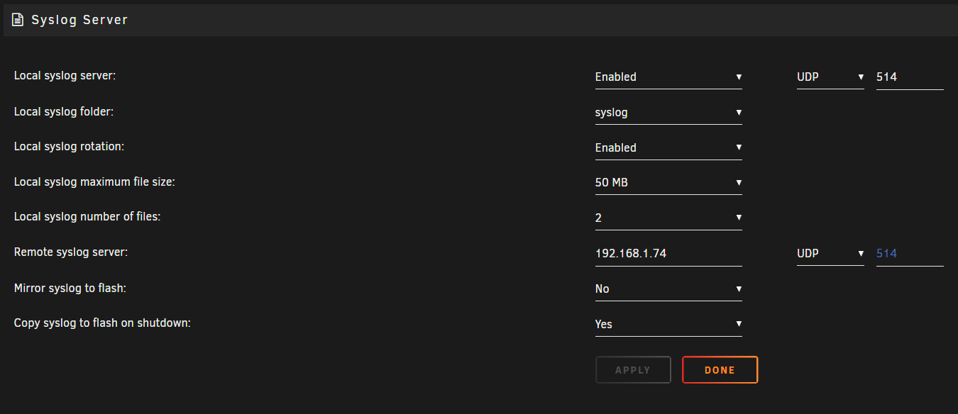

Do these settings look correct now?
syslog is a share setup only to write to cache
Settings look OK, try disabling and reenabling the syslog server, and then check to see if the syslog starts getting written to the syslog share.
