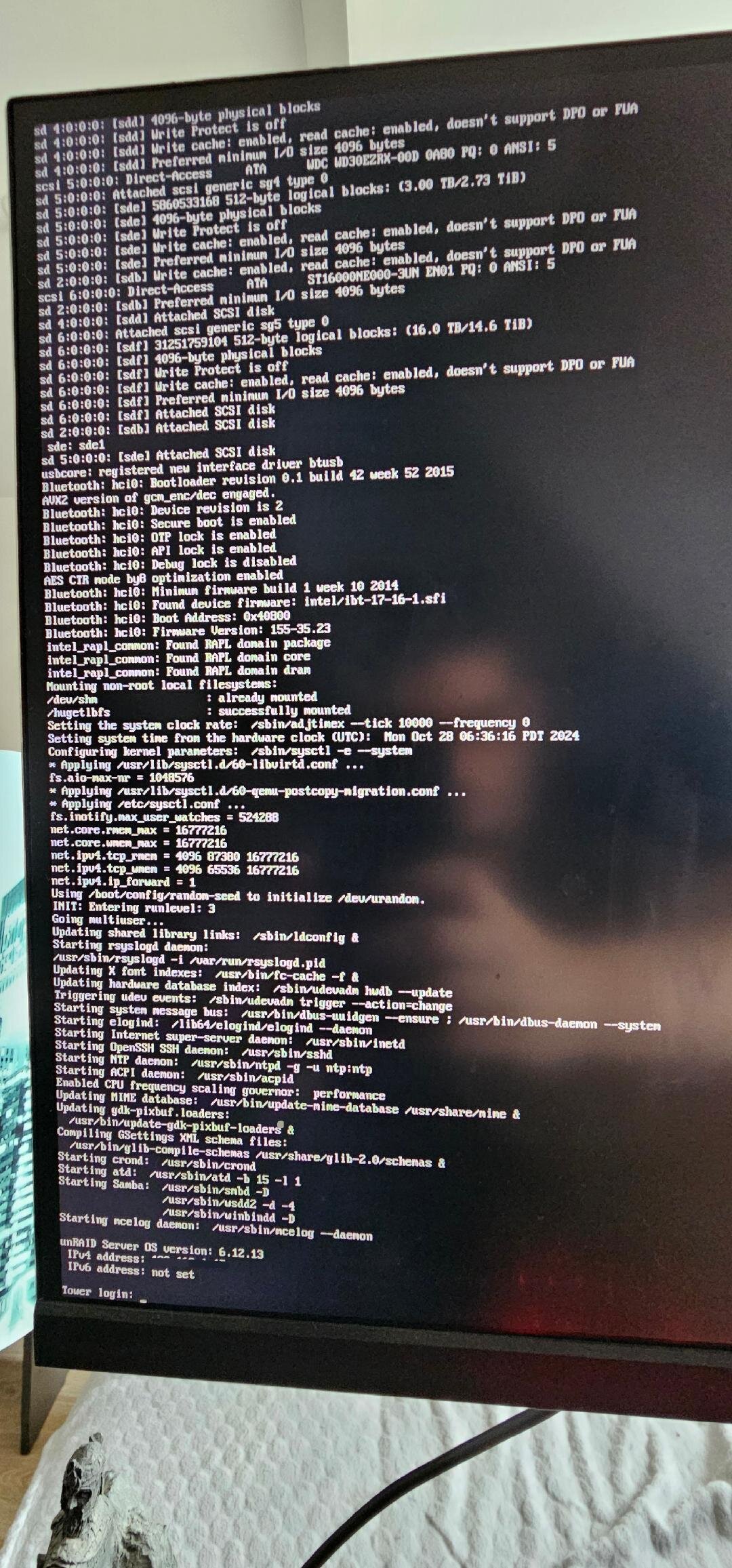

Post a photo of what the monitor is showing after boot.
it is goiing to be quiet tough to provide the diagnostics. why did the media unraid creation tool not detect my usb key ?
You just need to type diagnostics, then do a quick press of the power button to shutdown, remove the flash drive and attach them here.
Everything looks normal to me, make sure everything is in the same internal network, and try accessing by IP:

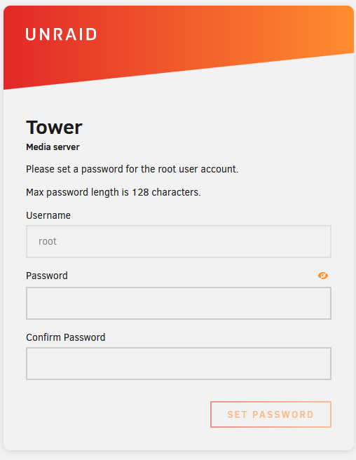

http://192.168.1.15
i was trying to access it with https and not http.
Many thanks for your help !!!!!
