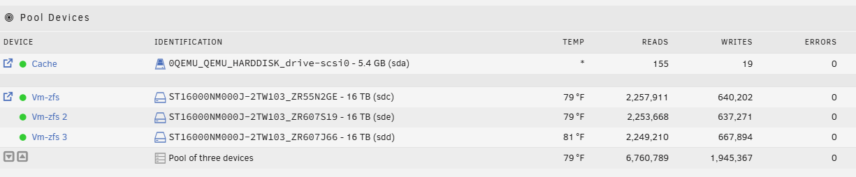

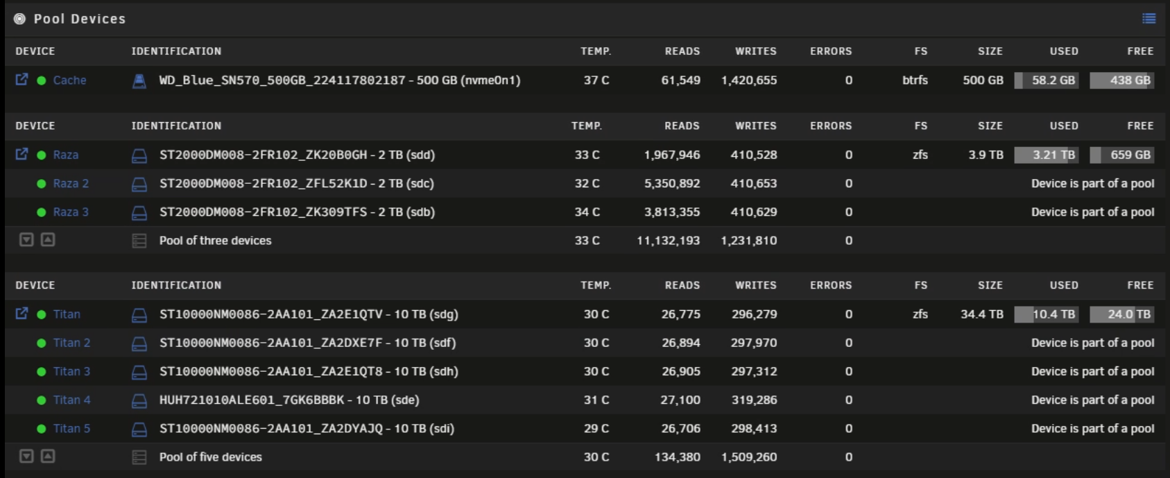

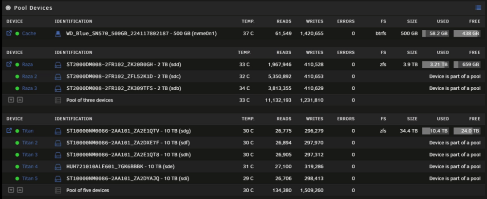

While Vm can take a performance hit as they should be on the faster drives. I can see you using 3 pools
as another example
2x nvme xfs array
no cache
2 pools of 4x22TB as zfs raidz2
You could in theory then use the array for vms, dockers etc...
Ideally for easy of management i would recommend staying with zfs and a pool only setup.

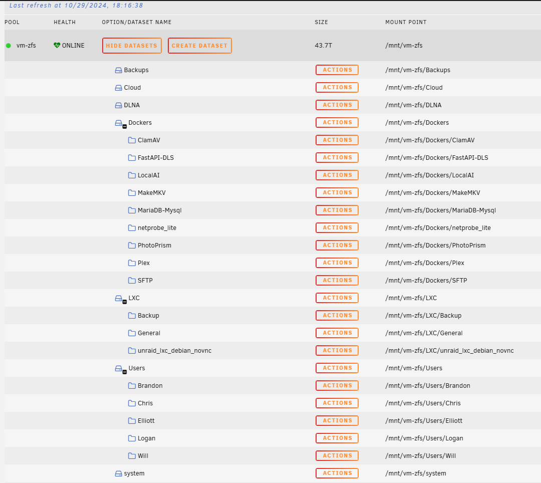

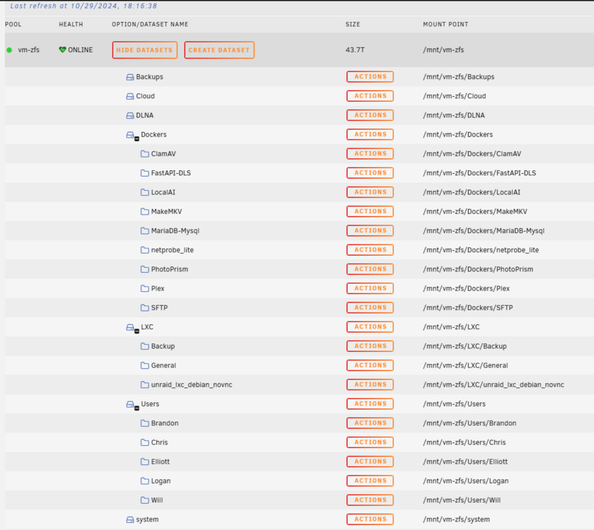

as for your data folder hiarcy here is an example that i'm running on unraid v7 beta 4:
example of some use scrpts i run:
