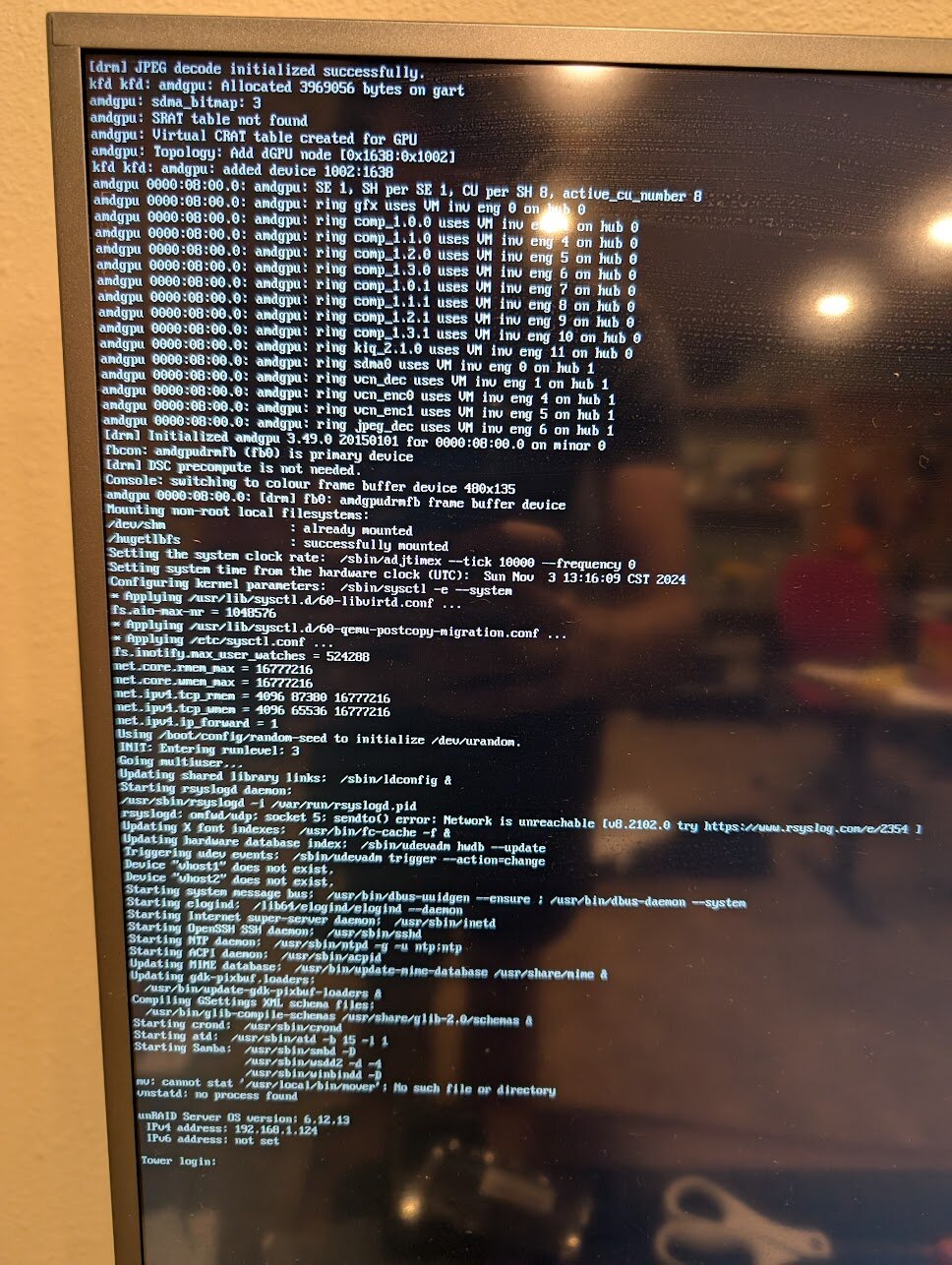

Anyone want to give me a sanity check on this pre-boot stuff?
Looks normal to me.
Cool - well here is the latest.
