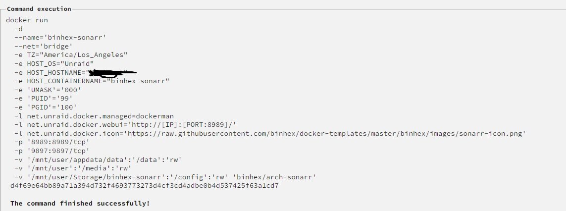

Even better would be your docker run

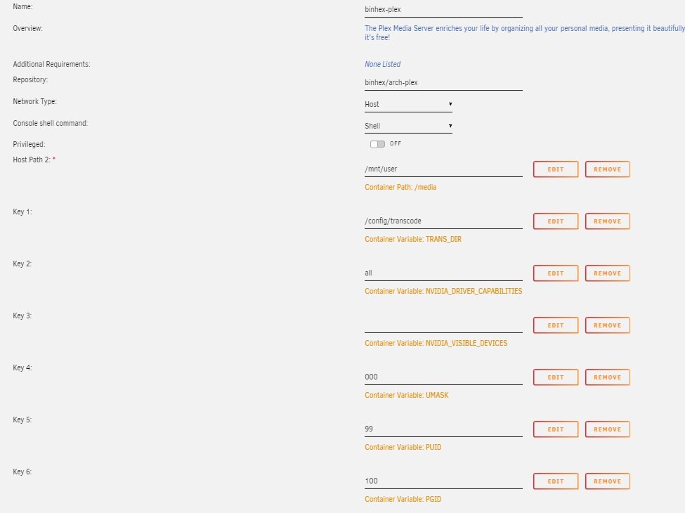

1 hour ago, TwoWheelUnion said:
I see a couple things you can improve on here:
1. Your media should be stored in a root share that you would have created. For example: /mnt/user/plexmedia and then inside that would be your plex library folders "movies" and "tv shows"
Your first path should be changed from /mnt/user to /mnt/user/plexmedia (or whatever you call it)
2. The transcode path is not a valid unraid location, ideally you'd just delete this or leave it blank and let plex handle it. If you prefer to transcode to your system RAM you could change it from /config/transcode to /dev/shm
These should fix your issue.
Thanks I made the changes.  I'll leave it for a couple hours and see if that fixed the problem.  I appreciate you taking the time.
What I did was change the path to the place where the media is located and changed the transcode path to /dev/shm.
Let's see what happens!

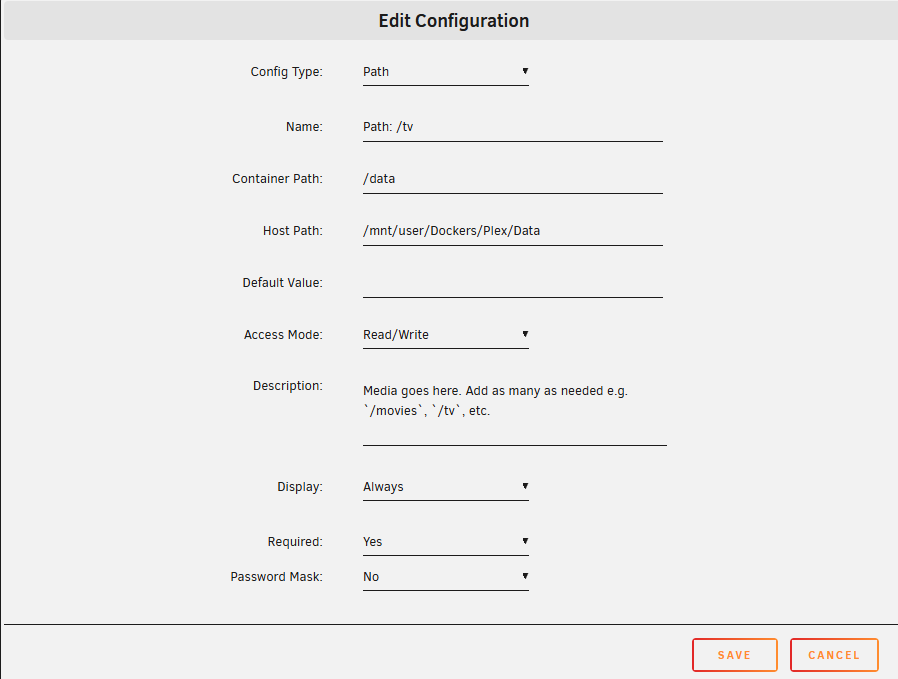

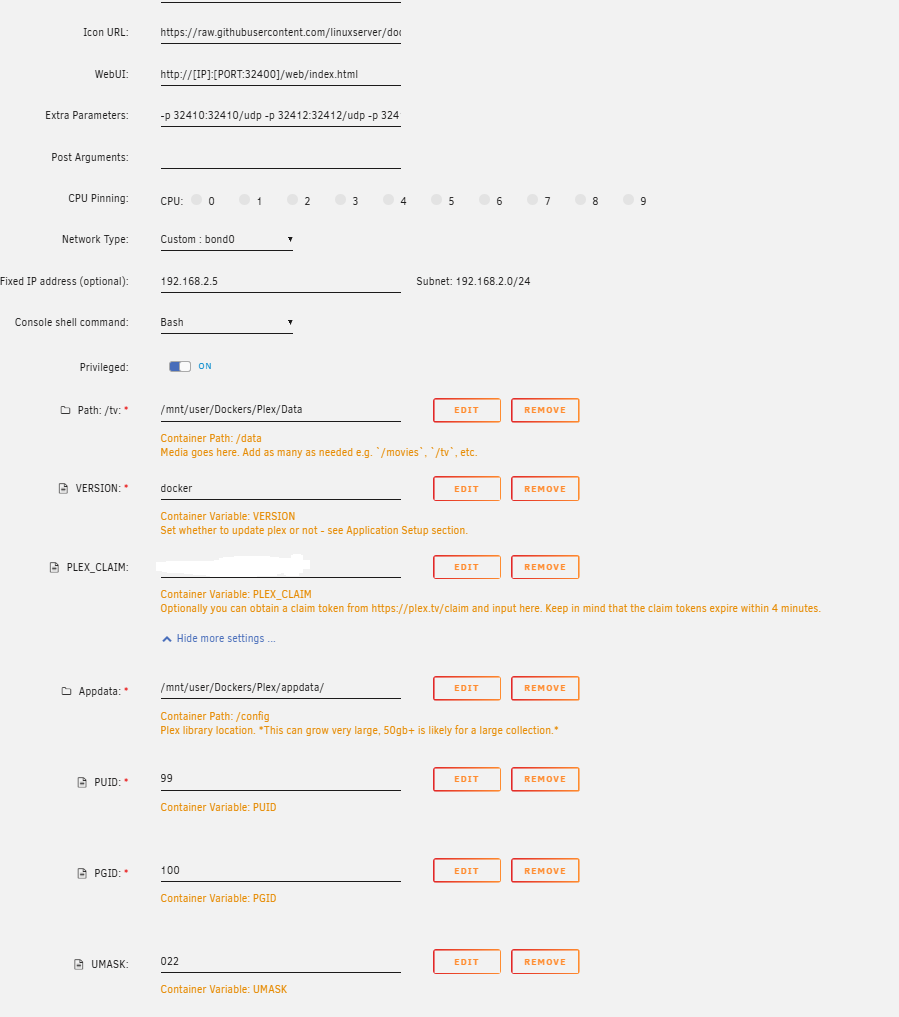

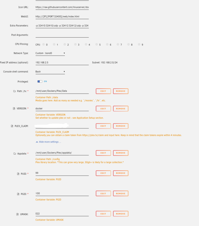

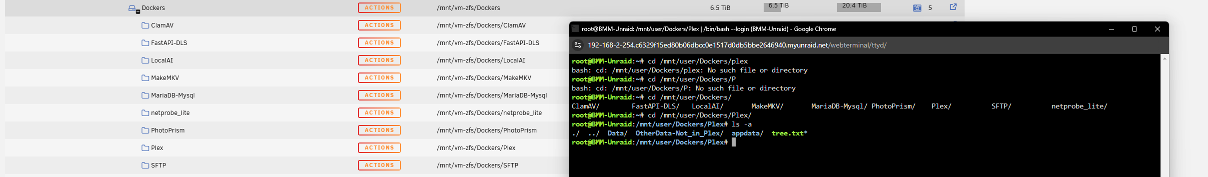

... template path datas:
In my case /mnt/user/appdata is Docker...
Inside data which is my plex files for movies, TV shows etc...
so in the docker template i pass:
/mnt/user/Docker/Plax/Data
as the continer see is as /data:

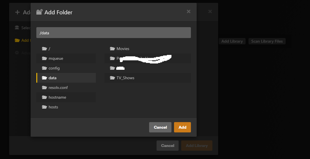

so in Plex when i add a libary that has Movie vs TV shows I add
/data/Movies:

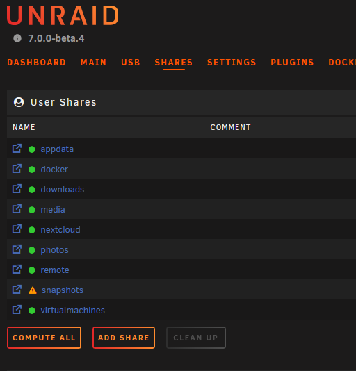

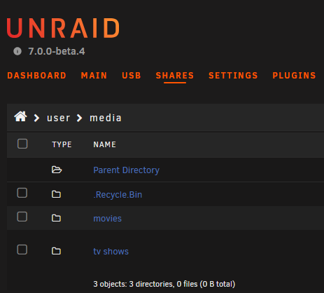

image.png.3c17280af077c15800b3175e30629860.pngimage.png.35f2c32b136925c3ff5bdc7a55462320.png
My setup has a "media" share that I use to store my "movies" and "tv shows" the host path of this location is "/mnt/user/media"
So for plex, I would map /media to /mnt/user/media so when you're inside plex, and you add a library, you'd navigate to /media/movies for the movies library and /media/tv shows to add a tv shows library
if it was not clear.

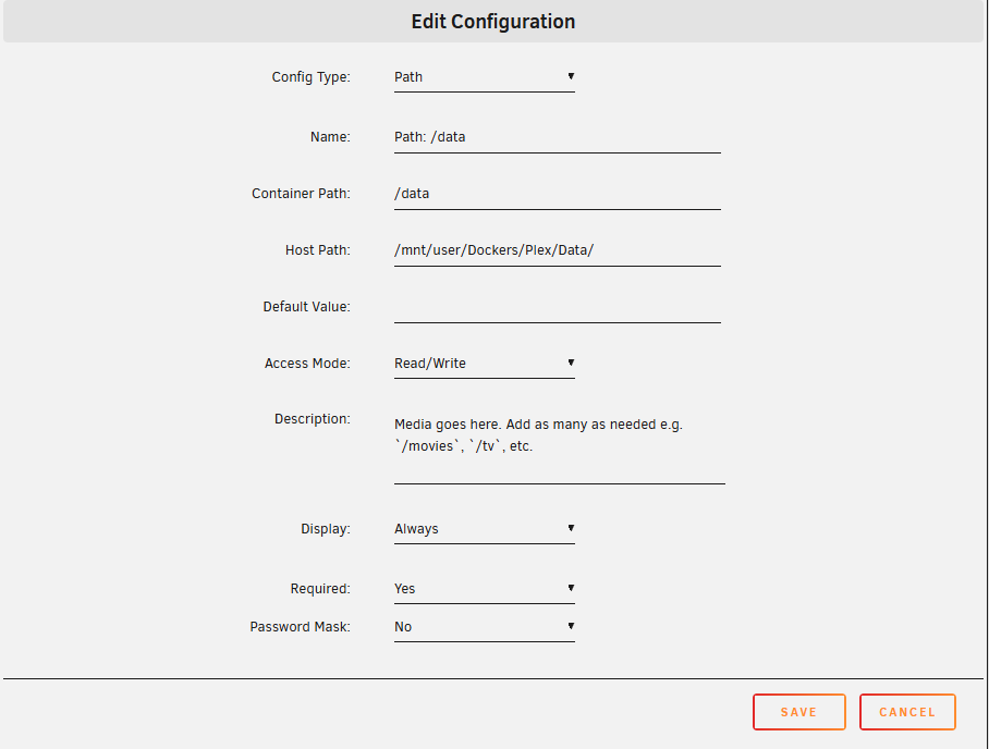

Example Setup:
*M<y Setup is not a normal setup. for backup plugins and other stuff i chose to do things this way usualy /tv /movies /pictures are 3 seperate location on your nas in 3 seperate locations thus plex would see /tc /movies / pictures to share...
So! Think of containers / dockers as type of VM, in that they have a seperate folder path that they read and understand...
In this case the Plex docker, the contianer has a "/pathname" in my case here /data
There are some default pathing as all linux systems run such as /root /home /var etc etc...
So when making a docker contianer path I must look at what services it has and where i want it to see the data at and then pass the data into the container.
Plex will see /data in this VM within its own root file system, Then with unraid folder pathing for /data is the content I want shared into or used for the plex docker to use.
Since this is a docker. We can control what /data points too...

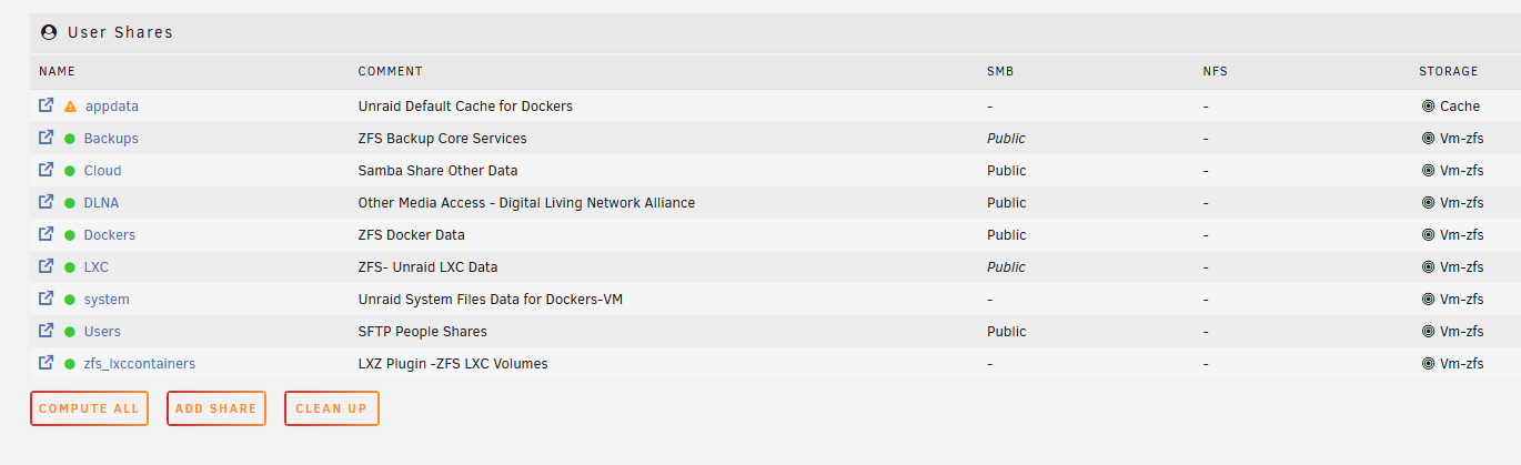

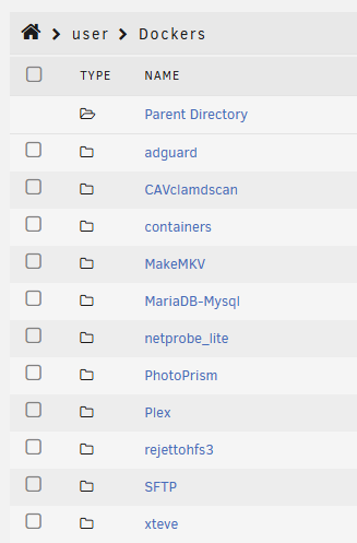

In my case, I have a unriad share name called Docker(see pictures above). In side Docker I have another folder hierarchy setup and since i have a docker, lets call it plex
and in plex I have a unique folder structure. (more for my backup scritp and interaction with plugins for a ring sync.
So I tell the unraid plex template that /data is /mnt/user/Docker/plex/data (which contains my 3 media folder)
Since this is plex and plex doesn't like videos and tv shows together, (As its a pain for metadata and how plex database auto sets file path sets and organizes / fixes its own data.)
in my media folder has a folder for  /tv /movies /etc ....

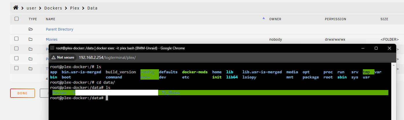

Plex /data will now see the data I want passed to it in one location, so when setting plex stuff i know its at /data/whatever-subfodler-name....
So the container Plex when I docker console and cd into /data. I see my folders on unraids disk. in that case its my list of... In Plex under setting librat i then tell moveis/tv /picture to point at /data /movie /tv etc...
