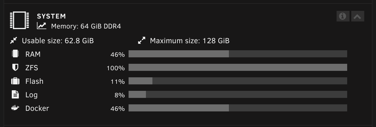

Also, on the dashboard page I see the following for system stats. I'm not sure why ZFS shows 100%...could this be the root cause? If so how can I fix it?
UPDATE -- I switched the PRIMARYCACHE from all to metadata for all zfs pools and restarted the array, now I'm down to only 1% utilization of the arc size (8GB). After a disk io test it's already up to over 25% again. I'll keep an eye on it and see how it goes. The perf test after the reboot isn't much better but the guest VM seems responsive at least...for now.
UPDATE -- after being on for just an hour or two ZFS usage is all the way back to 100%
This is normal and a good thing, it means it's using all allocated ARC RAM.
RAIDZ1 is not for VMs since the IOPS are the same as a single device, mirrors would be better, even better for performance would be using a zvol on a mirror, instead of a vdisk.
