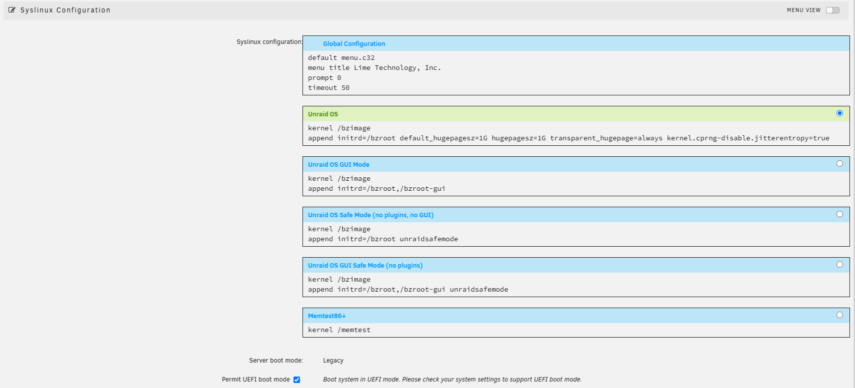

append ... ctrl-alt-del=0
Main > Flash > add system linux options...
This should work - untested as i want that feature..
kernel /bzimage
append initrd=/bzroot ctrl-alt-del=0
