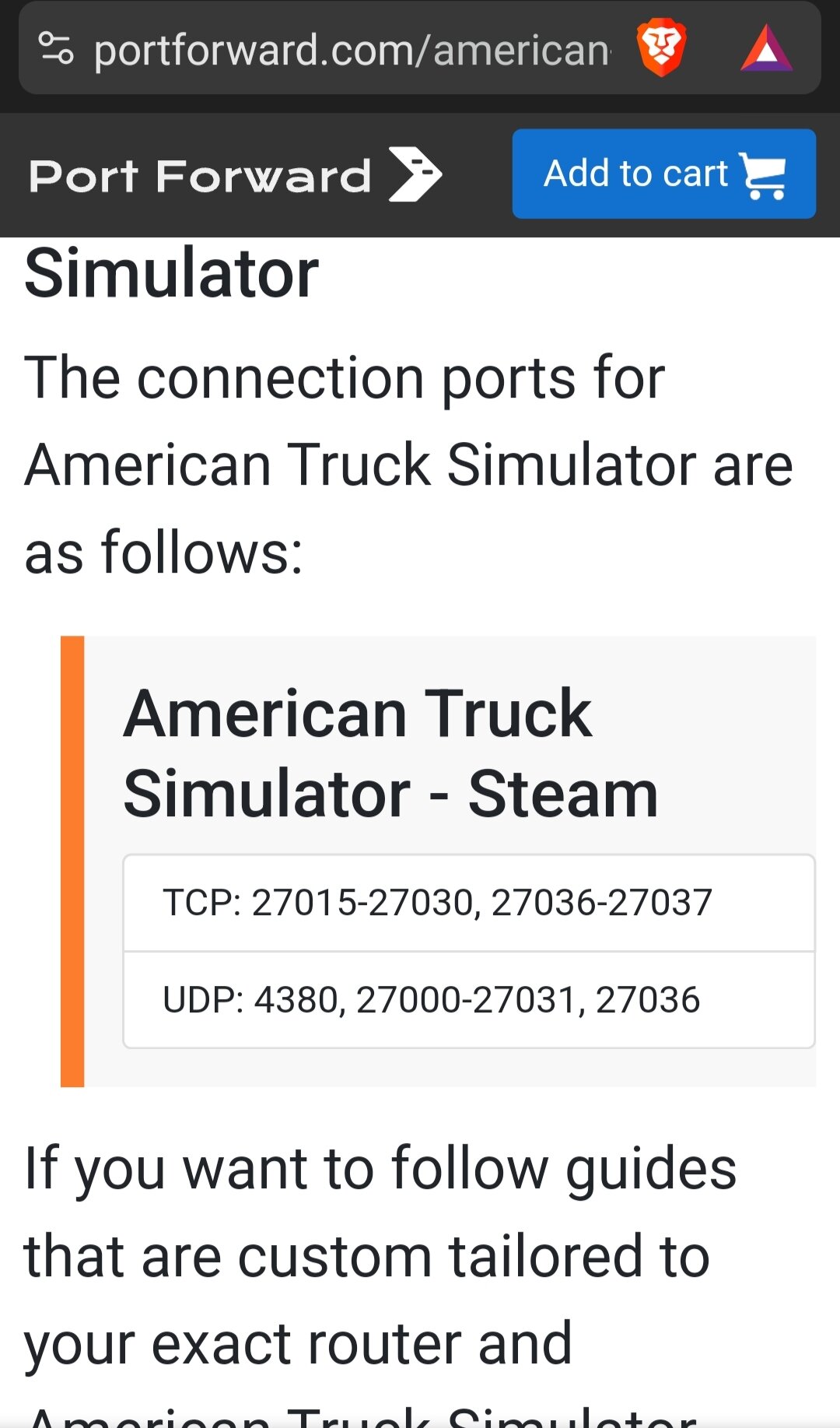

I'm not versed with this game but this here looks like some more ports to forward.
I'll try this tomorrow and update this thread on if it works. Thanks
No luck still same results. Starting to wonder if something is wrong with the docker and I should start over fresh
